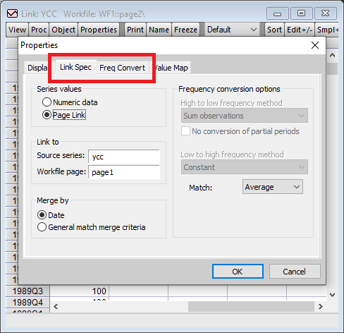

I was able to confirm the issue, but it'll take some time to work out the best way to fix/change this. In the meantime, I can tell you what's happening and try to provide a workaround.
The series link objects you're creating have both "Link Spec" and "Freq Convert" settings, with a unique frequency conversion option defined for each.
The "Link Spec" conversion setting is basically how the linked object is doing the conversion from the source to itself. Think of this value as a "link back" to the source. The "Freq Convert" setting is more of a "link forward" value that should be the new conversion default when this object is the source for something else. Meaning if this object is ever the source for another object, the default conversion option to use will be defined by this setting.
Beginning with EViews 11, we stopped defaulting the "Freq Convert" value to the "Link Spec" value when a new series link object was created. So in EViews 10, the new linked ycc object would have "Sum observations" under both "Link Spec" and "Freq Convert". But in EViews 11, only "Link Spec" would have that value while the "Freq Convert" setting would be "Specified in source" which really just means the application default here (defined under General Options menu/Series and Alphas/Fequency conversion). I know the name here is a bit confusing, so that's one of the things we'll need to work on.

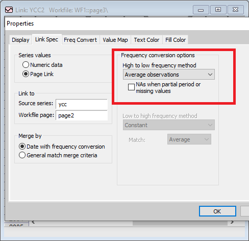

Series Link to Series Link
Now this change isn't normally a problem -- until you try to create a series link to a series link. The code performing that is only looking at the "Freq Convert" value of the source object which for EViews 11 is just default ("Average observations" if you haven't touched this under General Options menu).
Because of this, you can see the Link Spec for page3\ycc2 (under EViews 11) is:
