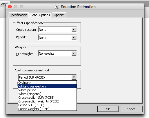

Hi, I am using EViews11 Student Version on Mac. For the attached panel data, I would estimate my model with HAC (Newey-West) as mentioned http://www.eviews.com/help/helpintro.ht ... rrors.html. However, I only see these options as attached.
Why I am not able to see HAC (Newey-West) option? Can you please guide me?

Not available for panel models.
