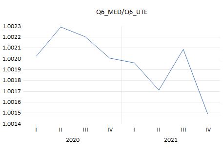

If I run the code:
%fcastsmpl_first = "2020Q1" %fcastsmpl_last = "2021Q4" 'scenario UTE %a="ute" _kvarts.scenario(n, a = %a) %a smpl %fcastsmpl_first %fcastsmpl_last _kvarts.solve 'scenario MED %a="med" _kvarts.scenario(n, a = %a) %a smpl %fcastsmpl_first %fcastsmpl_last _kvarts.solve 'comparing results line q6_med/q6_ute
I get the following result:

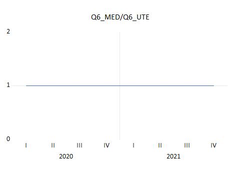

However, if I add a PAGESTRUCT command:
%fcastsmpl_first = "2020Q1" %fcastsmpl_last = "2021Q4" 'scenario UTE %a="ute" _kvarts.scenario(n, a = %a) %a smpl %fcastsmpl_first %fcastsmpl_last _kvarts.solve 'PAGESTRUCT command pagestruct(start=1975q1) 'scenario MED %a="med" _kvarts.scenario(n, a = %a) %a smpl %fcastsmpl_first %fcastsmpl_last _kvarts.solve 'comparing results line q6_med/q6_ute
I get the result:
Is this a bug with the pagestruct command?
