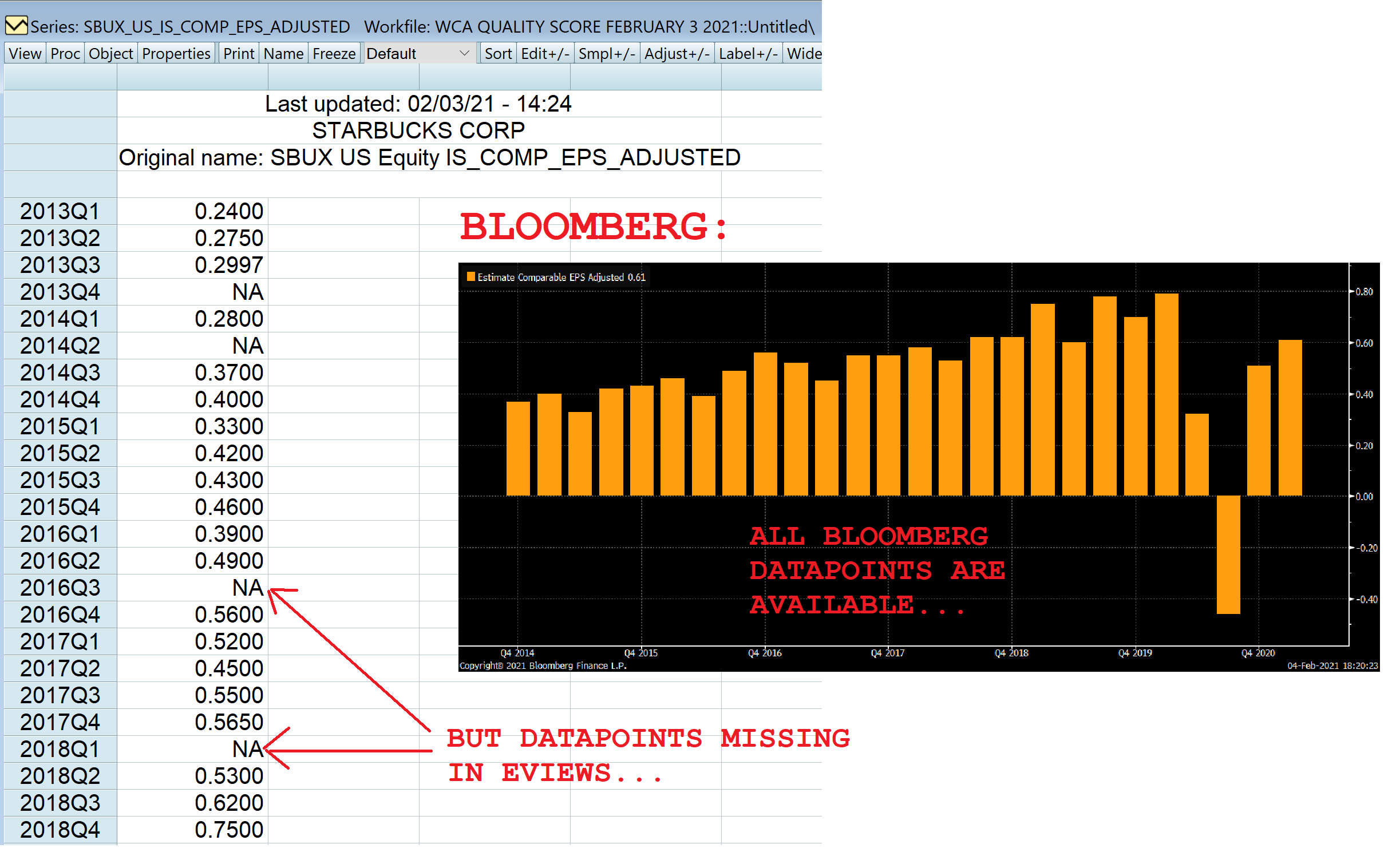

I have a program in EViews 12 Enterprise Edition wherein I import quarterly earnings data from Bloomberg using this:
dbopen(type=bloom, server=localhost:8194) None
FETCH BLOOM::"SBUX US EQUITY IS_COMP_EPS_ADJUSTED"
When I look at the earnings series on my Bloomberg terminal, it is perfectly complete with numbers each quarter.
However, when I look at the series in EViews, there are several missing datapoints with NAs displayed instead. I can run the fetch over and over, and get the same results.
I'm attaching a picture that shows what I'm seeing on both EViews and Bloomberg.
I'm hoping that I've done something wrong in opening Bloomberg or in the fetch command.
But, if this is an unfixable bug of some sort, is there a way for EViews to give me the average of the datapoints before and after the missing data rather than throwing an "NA?" That would be a second best solution to the issue.
Many thanks!
Kevin
Bloomberg Missing Data
- missing_data.png (184.49 KiB) Viewed 25414 times

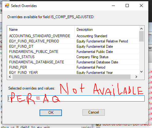

However...
When I try to use that Override code in EViews, Eviews chokes on it.
When I try to find that Override code in the "Select Overrides" Bloomberg Database Dialog box, it is not available (see picture).
And when I try to insert it directly in code, EViews doesn't recognize it either...
In order for me to make this work, I think I need EViews to be fixed to allow the PER=AQ Override Code...
Unless, of course, it can be used, but I'm just not entering it correctly in my code.
EViews Code: "SBUX US Equity IS_COMP_EPS_ADJUSTED PER=AQ"
Many, many thanks for all your help with this!!!
Kevin

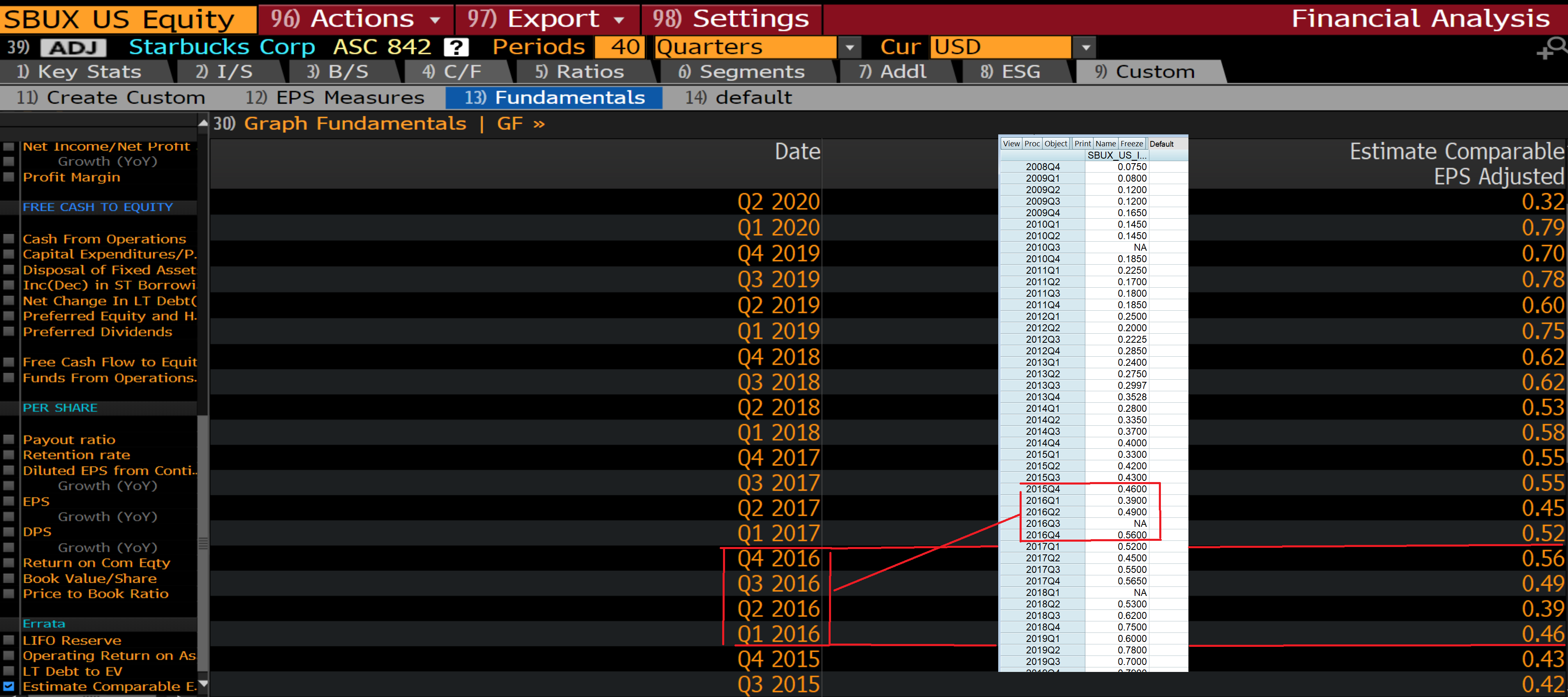

Just following up on this...
I just tried all the other Bloomberg Overrides available on EViews to see if any of those might produce the same result as Bloomberg's help desk's recommended "PER=AQ" override when using Bloomberg BDH codes in excel.
Beyond the "override" availability issue, I'm noting that the data isn't landing in the right quarters when imported into EViews from Bloomberg. I'm not sure if this is a related or separate issue though...
I'm attaching another image which shows the EViews data right alongside what I see on my Bloomberg screen. Notice that the data isn't landing in the right periods once fetched into EViews.
Sorry for being so persistent about this, but I'm really stuck and am desperate to make this work for a major project.
Many thanks for all your help!
Kevin
