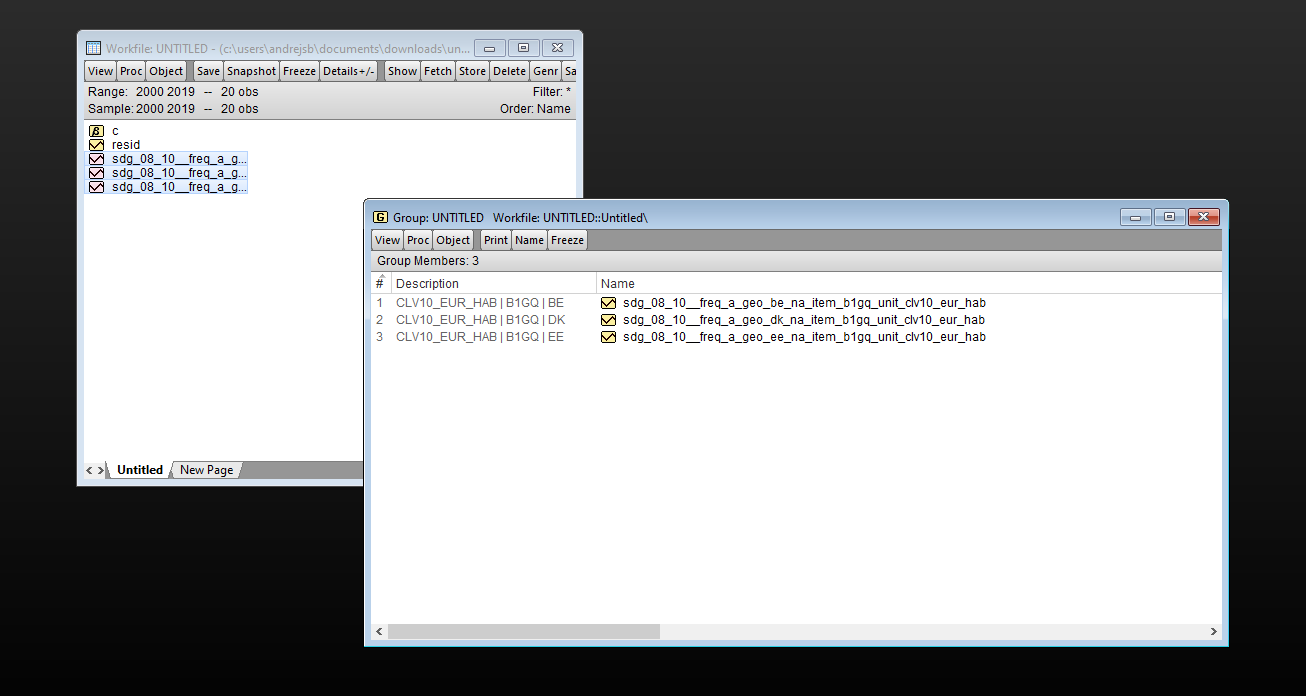

Dear Eviews,
Have a look at another bug...

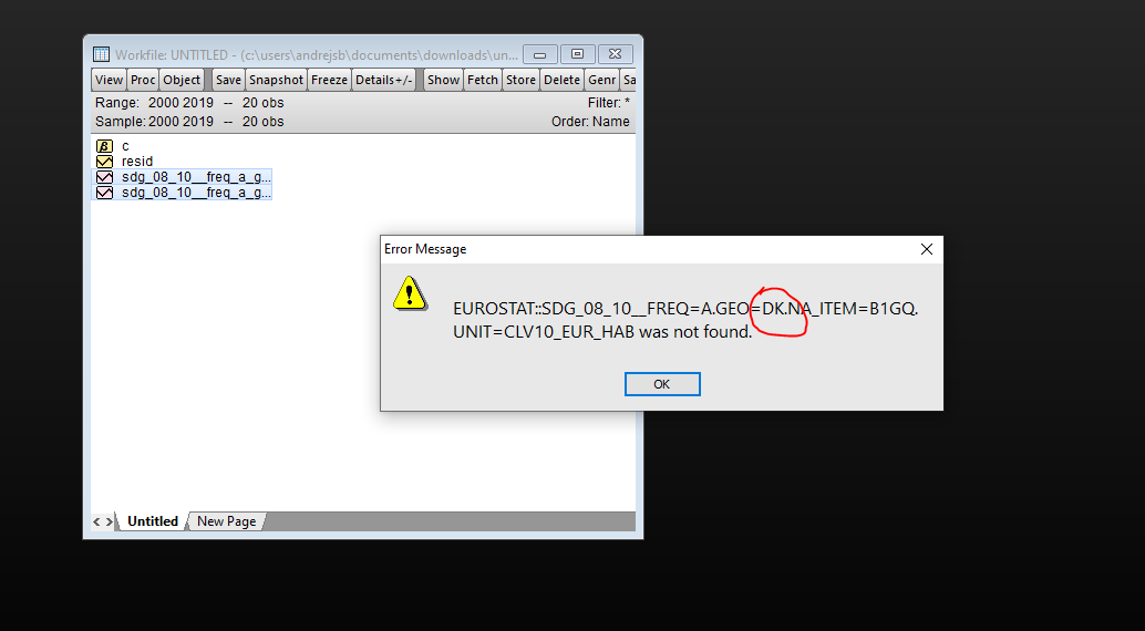

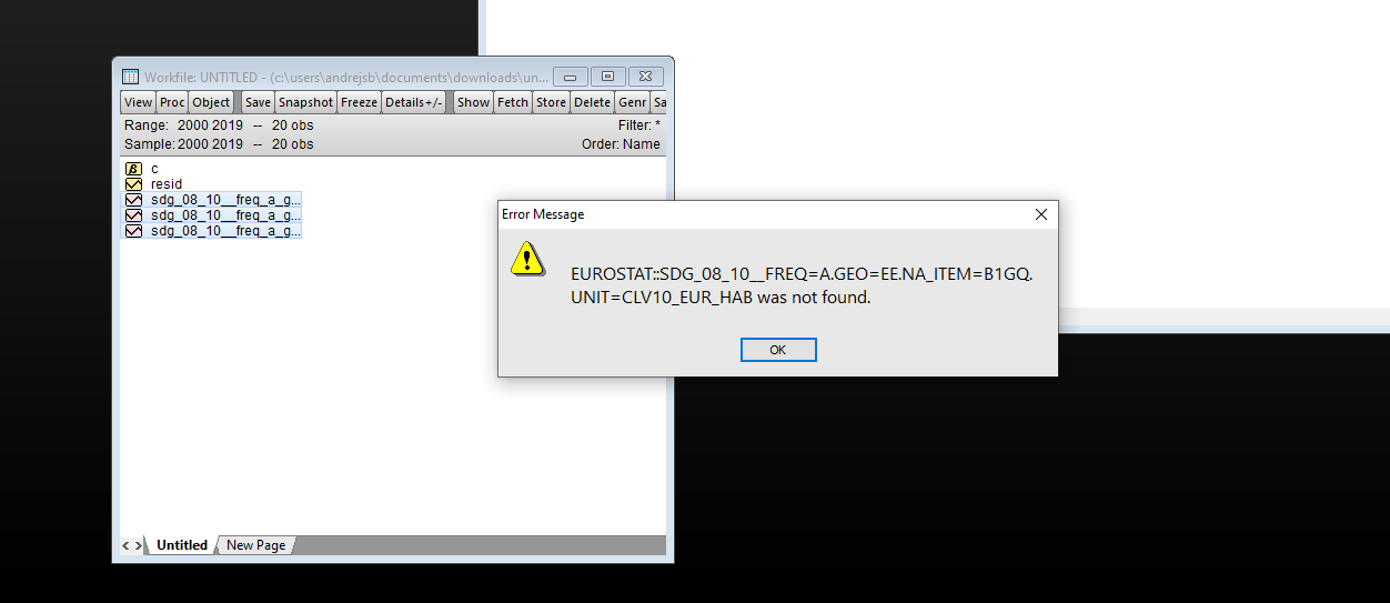

1. I fetched from EUROSTAT 3 series of GDP - Belgium (BE), Denmark (DK) and Estonia (EE). and store the workfile with links to update.
2. I open WF once again and try to update. Eviews updates all, but the last series in th WF - Estonia. I got message - I cannot update EE.
I click "update" on Estonia and I able to update one single series.
3. What I do? I delete Estonia and try to update all series once again. And I got message - I cannot udpate DK (the last series)
4. Conclusion - every time I want to update WF, Eviews cannot update the last series! Could you please to fix it?
Best
Andrejs
Re: EUROSTAT database
Posted: Tue Dec 08, 2020 4:04 pm
by EViews Katerina
A fix on this issue was posted on latest patch (Dec 8 2020 build)

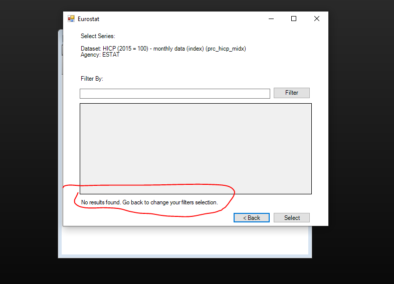

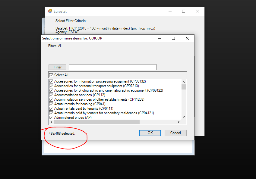

One more question.
Are there any restrictions how many series I can download per session?
Look, I tried to select all 468 variables of euro area HICP indices, but application says "no results found". It's not really true. If one selects fewer series, then I'm able to download them...
It seems that there is some sensitivity to filters or something ...

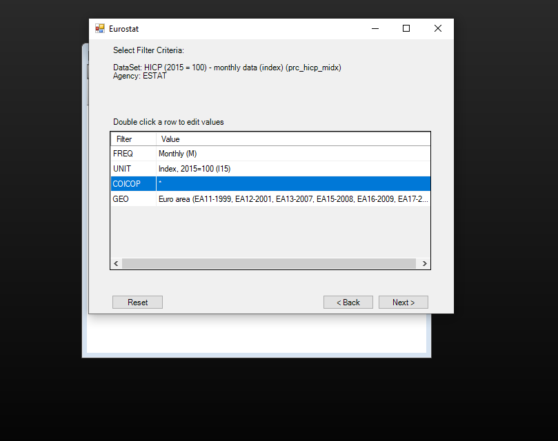

Posted: Wed Dec 09, 2020 12:51 pm
by EViews Katerina
Selecting filters for all SDMX databases is very important for reducing the speed or the query and the size of the results. When filters are not selected it means we will try to fetch everything (any number of series at any time) from a dataset.
I checked your query for Eurostat for the Dataset HICP without filters and saw that the response was:
>Response too large due to client request
>Query size exceeds maximum limit (1000000 entries)
Adding filters for COICOP and GEO for the specific HICP dataset will result in less entries and EViews will display the results.
You can see the error of the query without any filter by opening browser and pasting this url :
http://ec.europa.eu/eurostat/SDMX/diss- ... hicp_midx/ )

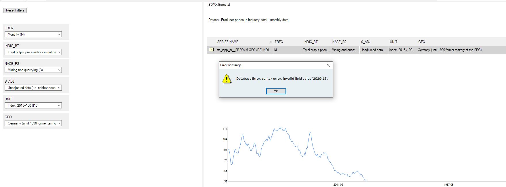

Posted: Fri Jan 29, 2021 5:47 am
by ErikG
Hi, fetching data from Eurostat is not working great at the moment. I guess the fault may perhaps be with Eurostat rather than Eviews.
The interactive filter list is slow and I find it difficult to make selections. Once I was able to select a series this appeared:
Regards,
Erik
/Eviews 12, dec 8 2020 build
Posted: Fri Feb 05, 2021 11:29 am
by EViews Katerina
Latest patch of EViews 12 (Feb 4, 2021 Build) has a fix for the issue.

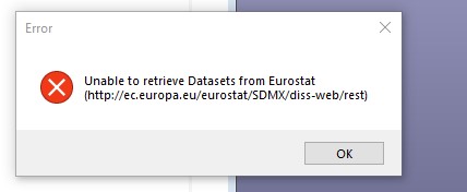

Posted: Thu Feb 16, 2023 6:04 am
by ErikG
Greetings from Sweden,
The Eurostat database is not working well with Eviews today. Opening the database and attempting to browse causes the following error with both Eviews 13 and Eviews 12:
Posted: Thu Feb 16, 2023 6:34 am
by EViews Gareth
Eurostat have discontinued the API that EViews uses. Unfortunately it will be some time before we are able to connect to Eurostat, I believe.
