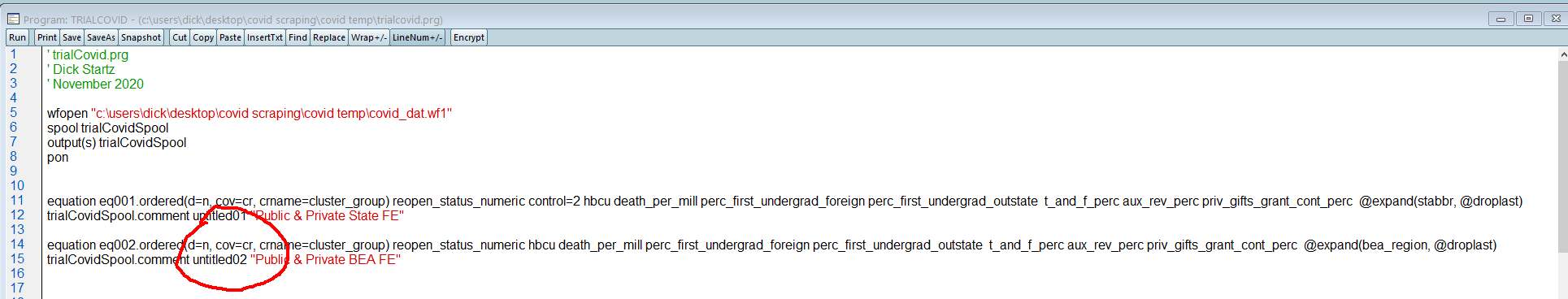

Postby startz » Tue Nov 10, 2020 3:45 pm
I'm being slow today
trialCovidSpool.comment trialCovidSpool.@objname(trialCovidSpool.@count) "Public & Private State FE"
gets
Screenshot 2020-11-10 144433.png (10.28 KiB) Viewed 21080 times

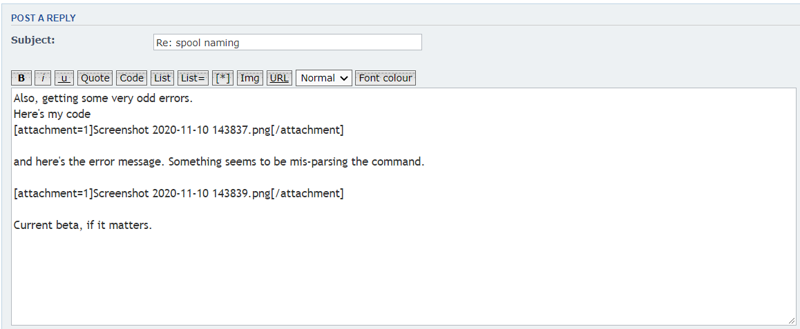

Postby startz » Tue Nov 10, 2020 3:50 pm
Also, getting some very odd errors.
Here's my code
Screenshot 2020-11-10 143839.png (39.24 KiB) Viewed 21080 times
and here's the error message. Something seems to be mis-parsing the command.
Current beta, if it matters.
Screenshot 2020-11-10 143957.png (8.96 KiB) Viewed 21080 times

Re: spool naming
Postby EViews Jason » Tue Nov 10, 2020 5:36 pm
We cannot replicate the issue. You shouldn't have to but if you restart EViews does the problem still persists?
Re: spool naming
Postby startz » Tue Nov 10, 2020 7:27 pm
Works after restarting.
