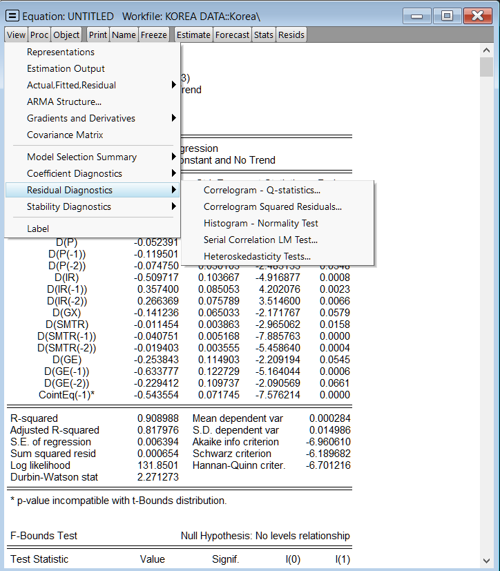

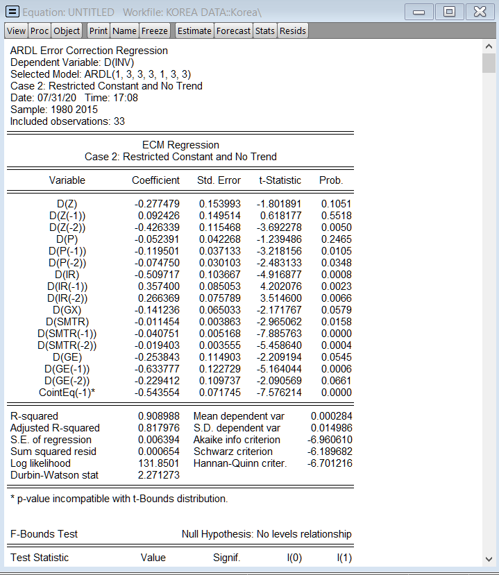

Hello. When I run the Error Correction Form in Eviews, it produces the ECM/ARDL parsimonious model.
When I then run the residual diagnostic tests (as pictured) for Normality, Serial Correlation and Heteroskedasticity, and CUSUM, are the results from the ECM/ARDL Model or the original ARDL model given when first running the ARDL Model? Can I use these results for my ECM/ARDL Model?
Collecting Residual results are obviously very important. Thank you.
Re: ARDL/ECM Question
Posted: Fri Jul 31, 2020 7:42 am
by EViews Gareth
Original ARDL

So how do I find the residual results for the ECM/ARDL?
Bth the original ARDL and the parsimonious ECM/ARDL use the same seated mod, so I'm guessing they have the same residual result???
The residuals from the contemporaneous and the ECM model are identical. All inferences on the residuals generated internally hold true regardless of the model transformation. Remember, the ECM is just a re-expression of the contemporaneous ARDL form. You can also verify this with a simple program I've attached below.
wfcreate a 1901 2000 'make some data series y = @rnorm series x = @rnorm series z = @rnorm 'estimate ardl with fixed lags (so we can more easily grab substituted coefficient specification below) equation eq.ardl @fl(y,1) @fl(x,2) @fl(z,3) 'make ardl residuals (not from ecm regression) eq.makeresids rez_ardl 'make and freeze the ecm output (since we can't grab ecm coefficients otherwise) freeze(ecm) eq.ecreg 'make cointegration vector called "coint" eq.makecoint coint 'grab substituted coefficient spec from ecm table %scoef = "" for !k = 1 to 6 if (!k < 6) then %scoef = %scoef + ecm(13 + !k, 2) + "*" + ecm(13 + !k,1) + "+" else %scoef = %scoef + ecm(13 + !k, 2) + "*coint(-1)" 'replace the "CointEq(-1)" instance with "coint(-1)" endif next 'replace any "+-" instance with "-" %scoef = @replace(%scoef, "+-", "-") 'make ecm residuals series rez_ecm = d(y)-({%scoef}) 'show difference between ardl and ecm residuals show rez_ardl-rez_ecm 'you can see that the residuals are virtually identical

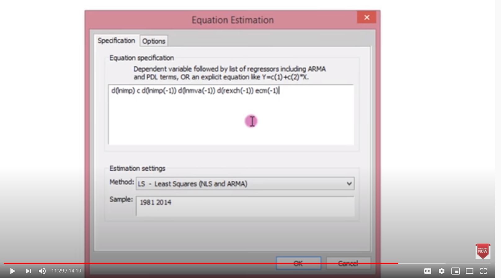

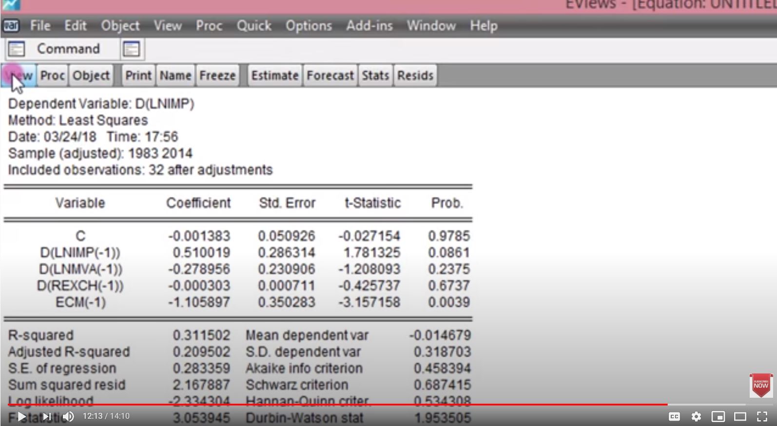

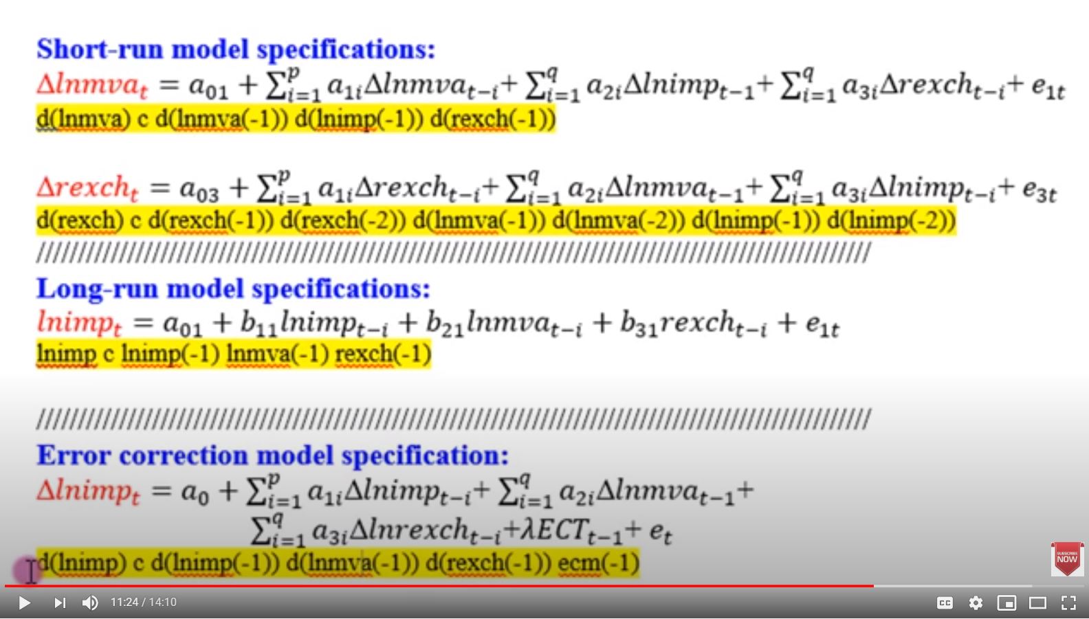

In explaining it simply, I have added photors:
Photo 1: Shows the short-run and long-run model specifications used in the LS - Least Squares method.
Photo 2: Using the long-run specification, you create the ECM series. Then you place in the LS equations (short run and long run) and run the model
Photo 3: You run the short run and long run (EMC model) with the LS method. The ARDL-ECM model is then displayed
As you can see, this is a different method used.
Are you able to tell me why authors use this method?
My supervisor seems to think that the long-run model is not specified properly here.
If you did this method and compared it to the Eviews method (that we have spoken about), the long run model and ARDL contain different coefficients completely.
What are you thoughts?

What is presented on the slide (last two lines) is nothing more than Engle-Granger procedure without testing for cointegration at the first stage (static long-run equation). I highly recommend not only watching videos on the Internet, but also reading original papers on the subject, as well as an exhaustive Eviews blog on the ARDL modeling.
The Engle Granger method is totally different from the method to do ARDL estimation when variables are of mixed order of integration. While Engle Granger is only allowed for I(1) variables.. However what Michael is trying to ask is, whether this method is correct... OLS estimation, to see wether all variables are statistically significant + then you can display the key statistics of the long run relationship (because this isn't given by eviews).
Given that the long run relationship is not equal to the eviews levels equation this must be incorrect. However in Eviews there is no possibility to choose a case where AND a constant in the levels (long run) equation is given AND a constant in the EC-model, while most papers like for example the good author Narayan (2005), best in the field, does display both..
Posted: Sun Aug 09, 2020 12:31 am
by igor
Once again: Long-run model specification and error correction model specification on the slide are not directly related to ARDL Bounds test. Long-run model specification is like the static level equation in Engle-Granger method. The error correction model specification is like second stage dynamic equation in Engle-Grander method. Definitely, OLS is correct here, see Nobel-price paper in Econometrica. Generally, the results will not coincide with ARDL model since it takes into account dynamics while estimating the long-run. So what is your question about? Eviews ARDL Bounds test is implementation of Pesaran et al procedure and nothing more (Eviews makes this even better than original paper and Microfit). All deterministic terms specifications in Eviews are strictly the same as in Pesaran et al (2001). What Narayan (2005) had added to this?
