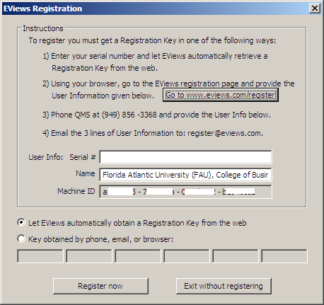

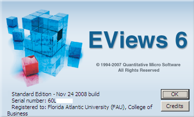

If you start EViews and select Help->About EViews, listed is your serial number. If the serial number begins with 60J.., 60k.., or 60Z (DO NOT POST your full serial number here on the forums, but you may post the first 3 letters), you are using a license manager. If not, you are using a seat license and no license manager. Assuming a license manager is being used, select Help->EViews registration. The displayed dialog will indicate where your license manager has been installed.
Let me know what you find and we can go from there.

Is there any ini file that might have the ip of the license server i could lookup?
Our current license starts with 60L and the new one starts 70L

You are correct 70L and 60L do not use a license manager. To install on 10 computers and only allow 5 instances to run simultaneously however, you need a concurrent use license. You mentioned you do have a concurrent use license, but we are getting a little too specific for a public forum. Email support@eviews.com your serial number and mention you were in correspondence w/ me on the forum and we can talk more.
