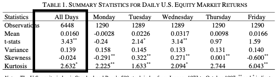

I am doing day-of-the-week effect for an assignment and i want to analyse the descriptive statistics.
Can someone please tell me how to compute the descriptive stats for each day as well as the whole sample. Please see attached picture. I want the same.

http://eviews.com/help/helpintro.html#p ... 23ww131866
Use @weekday as the classifying variable.
