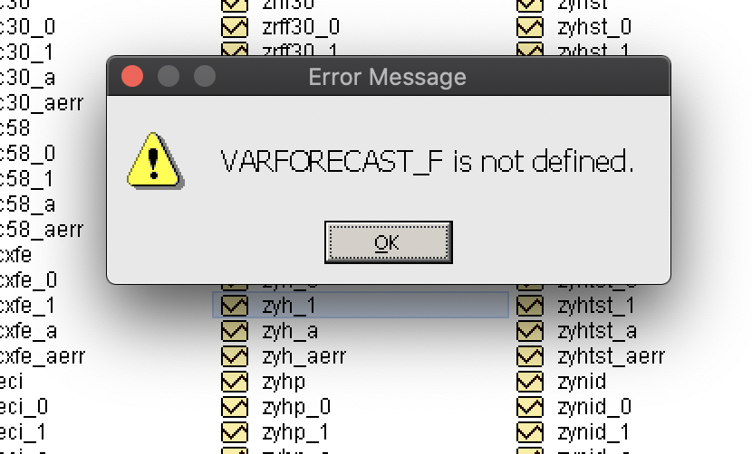

However, when I searched for "VARFORECAST_F" in the workfile, I could not find it.

Note that it is a naming suffix. Since a VAR is a multivariate model, the forecast will produce multiple series objects. Those forecast series will be named with the underlying series name plus the suffix you provide.
Re: Forecasting in EViews 11
Posted: Wed Jun 24, 2020 4:19 pm
by joshi27s
Ah I see. It worked, thanks
