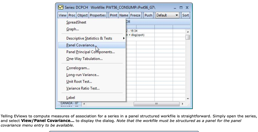

I am working on my master thesis using a dated panel set and I want to create a correlation matrix for my variables included in the regression. However, I cannot find where I conduct this correlation matrix with respect to that my data is panel data. When I read the Eviews help guide, see attached picture, it says that there should be a function called "Panel Covariance" but I cannot find this on my computer (using Eviews 11). I have inserted my data as dated panel of course from start.
Picture of Panel Covariance from help guide

Panel Covariance computes the covariance across panels for a single series, and as such is available from the Series View menu.
