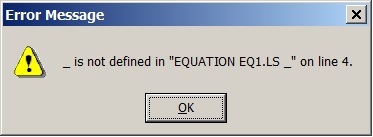

Manually breaking long lines of code with the underscore character in a program does not seem to work as described in the documentation (c.f., quotation below): the example code below yields an error.
Best, mamo
wfcreate a 2000 2010 series x=nrnd series y=3*x+4+nrnd equation eq1.ls _ y x c

With the current build, the trick seems to be that there must not be a space character immediately following the underscore ("_") sign in the first line in which the underscore is used.
In the following lies, the underscore sign can be followed by as many spaces as one may wish without creating an error.
(see example code below),
mamo
wfcreate a 2000 2010 series x=nrnd series y=3*x+4+nrnd ' There must not be an empty space after the underscore sign in the following line: equation eq1.ls _ ' The underscore sign in the following line may be followed by one or more empty spaces: y x _ c
