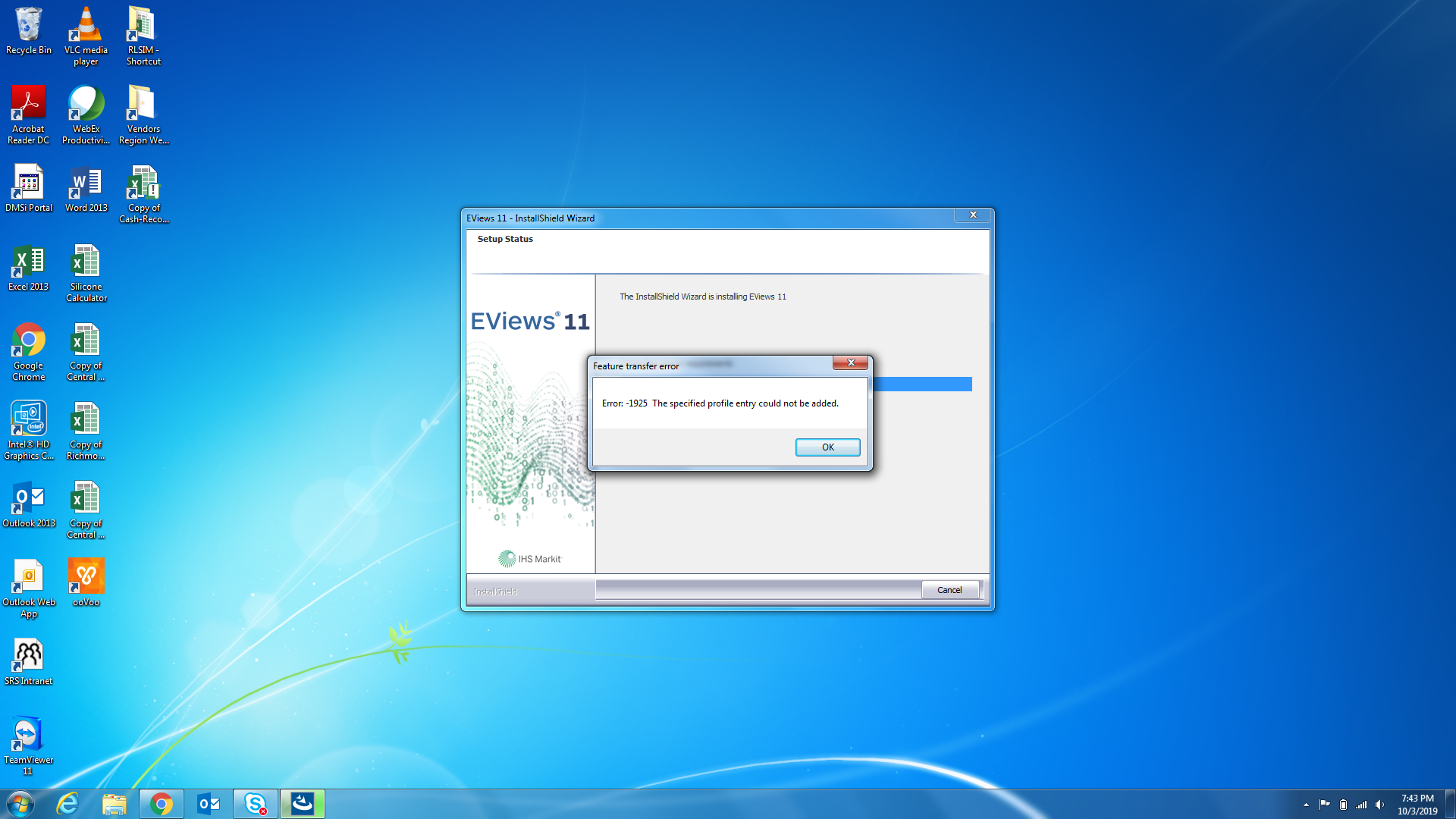

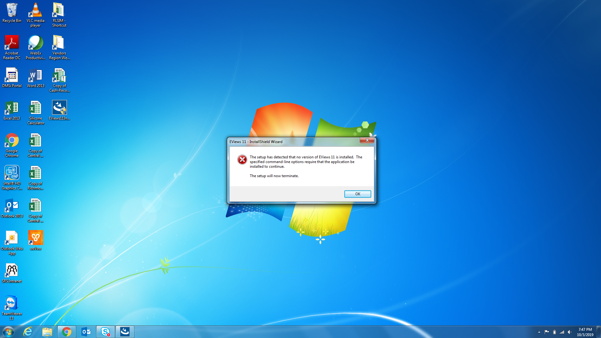

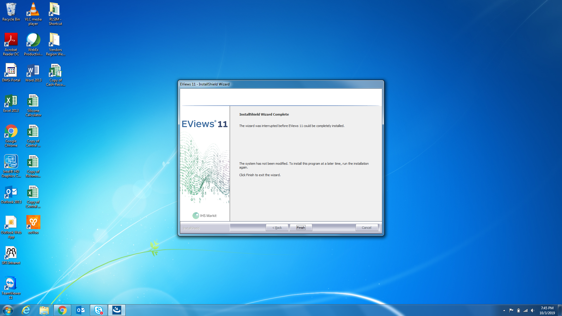

I am attempting to install Eviews 11 and I keep getting that error message. I'll attach screen shots of my steps.
First I get "Error - 1925 The specified profile could not be added"
Then "The wizard was interrupted before Eviews 11 could be completely installed"
Last message I get says; "The setup has detected that no version of Eviews 11 is installed. The specified comman-line options require that the application be installed to continue. The setup will now terminate"
Any advice of what to do?? I tried downloading Windows 32 bit and Windows 64 bit and get the same results.
