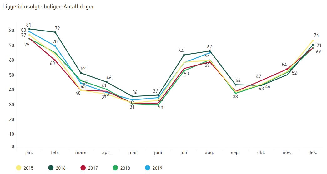

I would like to make the following graph in Eviews, but I haven't figured out how to stack the different graphs (which contains monthly data for each year) in the same figure.
[img]
Picture of the graph I want to make
[/img]
Until now I have done something like this, but I don't know how to get further.
'making one variable for each year smpl 2015 2015 genr rsliggetid_en2015 = rsliggetid_en smpl @all if @year=2016 genr rsliggetid_en2016 = rsliggetid_en smpl @all if @year=2017 genr rsliggetid_en2017 = rsliggetid_en smpl @all if @year=2018 genr rsliggetid_en2018 = rsliggetid_en smpl @all if @year=2019 genr rsliggetid_en2019 = rsliggetid_en

Postby EViews Gareth » Wed Sep 18, 2019 3:35 am
You'll have to use lags to line them all up.
Something like:
smpl 2019 2019 series x_2018 = x(-12) series x_2017 = x(-24) series x_2016 = x(-36)
