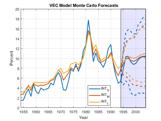

I am however interested in looking at the extreme quantiles of the simualtions. I am able to view these through Graph->Panel Options (clicking median plus quantiles) etc. Is there anyway of getting the actual data for these graphs as a time series as I am looking to plot these onto the original data to show the different paths (similar to what is done in the attached screenshot for another software package).
For now - I can only see the stacked data (1,000s of observations)
- VECModelMonteCarloForecastsExample_02.png (70.72 KiB) Viewed 10636 times

If you open one of the forecast series in the panel page you can click on View->Stats by classification and then use @obsid or @date as the classifier in order to view statistics (means, median, quantiles) across the simulations.
You can also use the by-group functions to generate new time series with the same stats.
