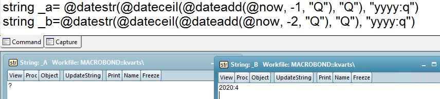

why does the string _a return a question mark?

by EViews Gareth
A quarter is 3 months.
Subtracting a quarter from 29th May (which is when I assume you did the operation, given that's when you posted the question), yields a result of 29th February. 29th February doesn't exist. So the result is an NA.

I would like to get a string with a date in the form "YYYY:Q", !X-quarters ago, using a code that works every day of the year.
Would this code do it?
@datestr(@dateadd(@datefloor(@now,"q") , -!X, "Q"), "yyyy:q")
Do you have a better alternative?
t
Re: String dates: the last day of x-quarters ahead
Posted: Sun May 30, 2021 9:35 pm
by EViews Gareth
That's how I would do it (although in my mind I floored to start of the month rather than start of the quarter, but same effect).
