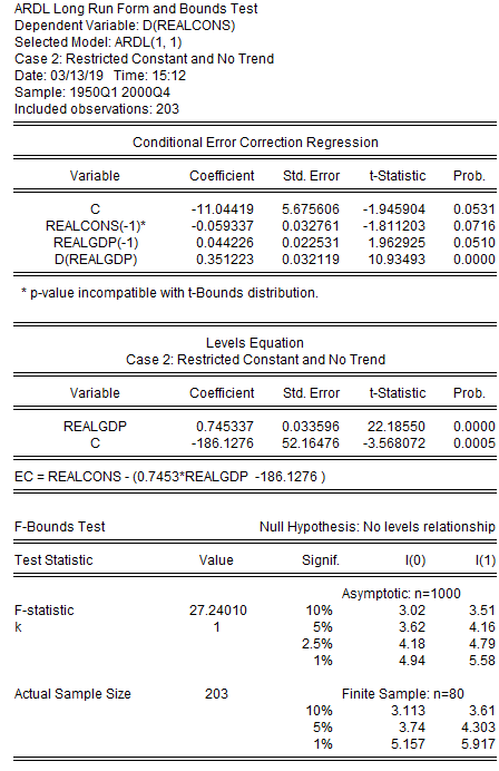

What we refer to as the "Cointegrating Equation" there is in fact the Conditional Error Correction equation in the View\Coefficient Diagnostics\Long Run Form and Bounds Test Form output. In particular:
[img]CECM.png[/img]

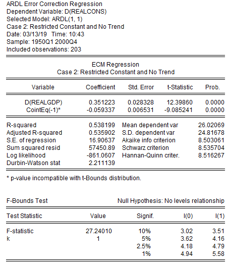

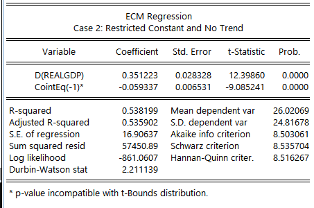

However, if you go to View\Coefficient Diagnostics\Error Correction Form, then you will see that we correctly display the ECM as you expect it to be displayed. Namely:
[img]ECM.png[/img]
Note that the images are added as attachments. In any case, I suppose we can look into relabeling the original output that brought confusion. I hope this clarifies things.
[img]CECM.png[/img]
[img]ECM.png[/img]

I think it would be more simple to understand if we write the Conditional Error Correction Regression in this way :
CECR
[img][/img]
Cointegrating Equation:
D(REALCONS) = -11.044185409502 -0.059336632737*REALCONS(-1) + 0.044225795161*REALGDP(-1)
+ 0.351223091007*D(REALGDP)
ECM
[img][/img]
Model:
D(REALCONS) = -0.059336632737*( REALCONS(-1) - 0.74533712*REALGDP(-1) + 186.12760617 ) + 0.351223091007*D(REALGDP)
REALCONS(-1) = 0.74533712*REALGDP(-1) - 186.12760617
In order to switch between the CECR and the ECM more easily. But, it is just a suggestion.

CECR
[img][/img]
ECM
[img][/img]
Model:
