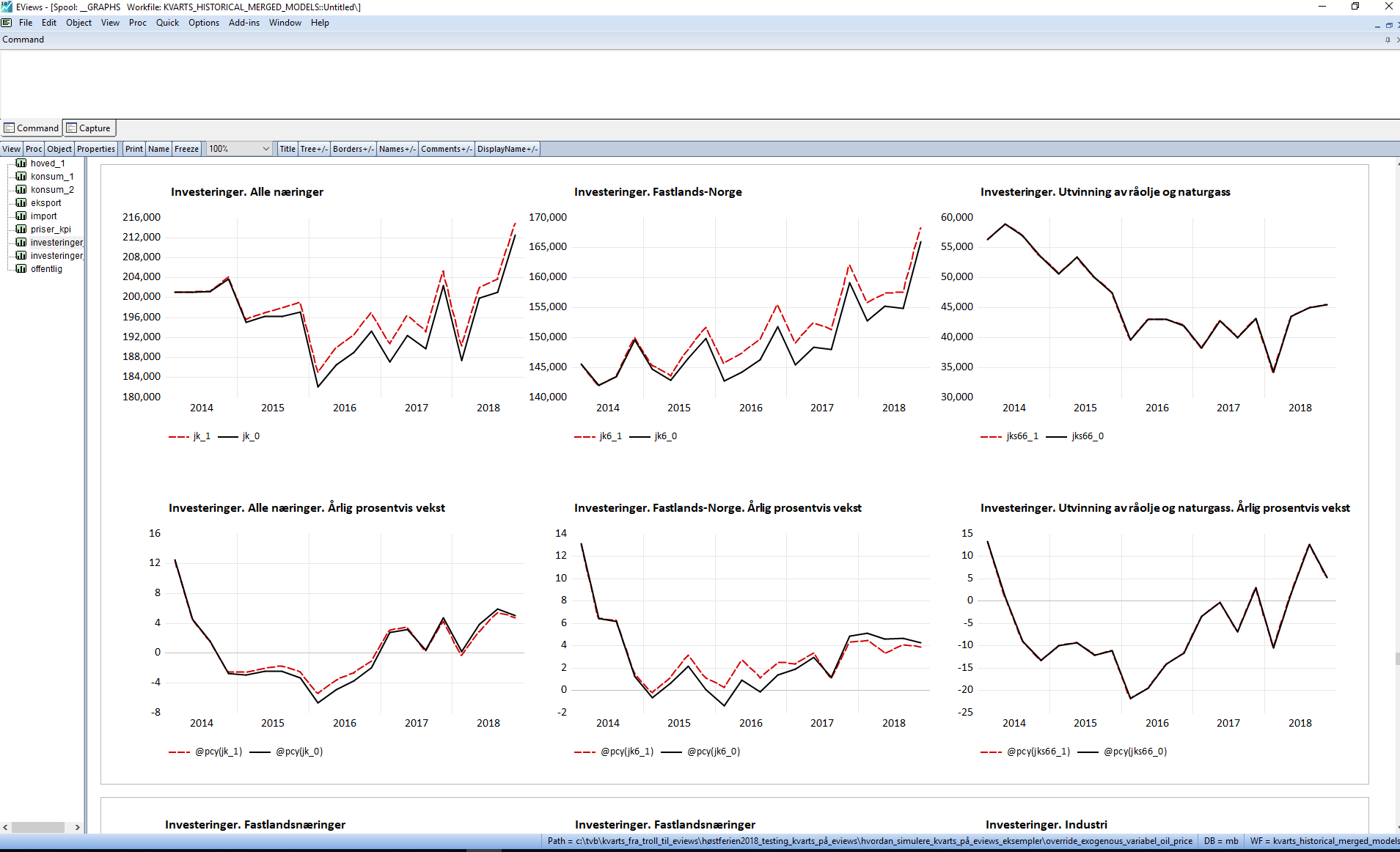

I have a spool with several graphs. I would like the graphs to have a width in the spool object that covers the entire EViews window/screen. I have used the code
spool.graphmode(type=fixed)
to manually ensure that this is done on my computer screen at work. Then it looks like this:

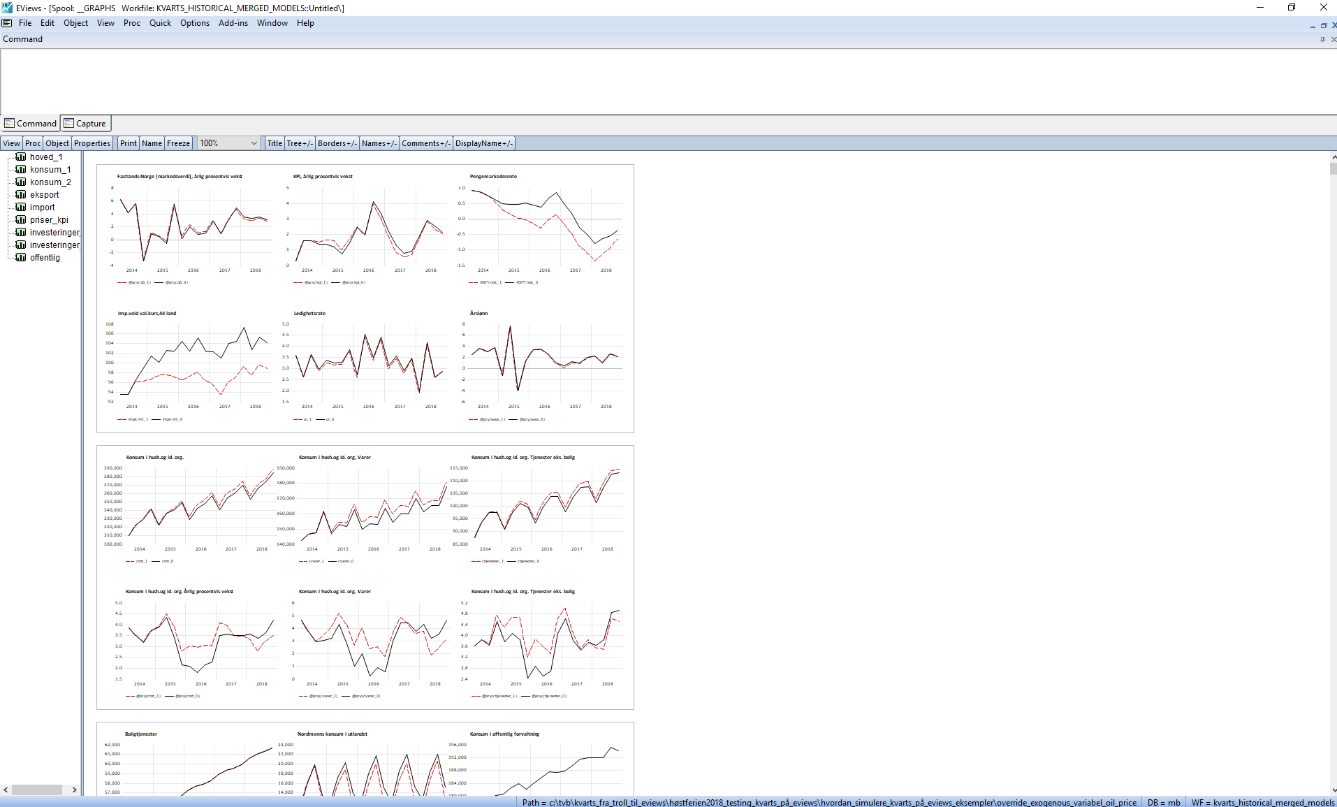

However, when I open it at my computer at home, it looks like this
Is there a way to ensure that the graphs within a spool object (when maximised) covers the entire EViews window/computer screen as in the first example above?

Try this:
spool.graphmode(type=fixed) X
where "X" stands for some number in inches.
Otherwise, try this:
spool.graphmode(type=variable)
