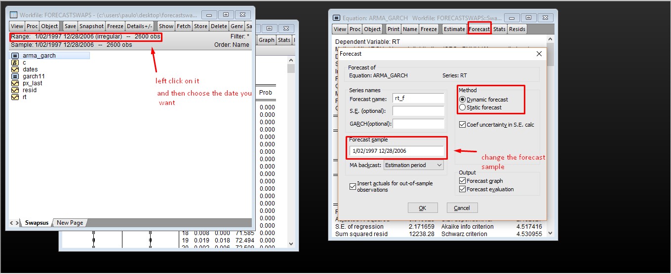

Hello David,
After checking the correlogram of rt it seems to follow an ARMA(1,1) which you have to estimate the "rt c ar(1) ma(1)".
After that you need to conduct the Heteroskedasticity Test, which confirms the ARCH effects. so You need to estimate the ARMA(1,1)-GARCH(1,1).
After that to perorm the out-sample forecast, You need to rearrange you range size and than perform the forecast with the method you want and for the sample you want.
I will attache the screenshot explaining and the workfile.
- david.jpg (153.83 KiB) Viewed 6649 times
- forecastswaps.wf1
- (104.81 KiB) Downloaded 381 times

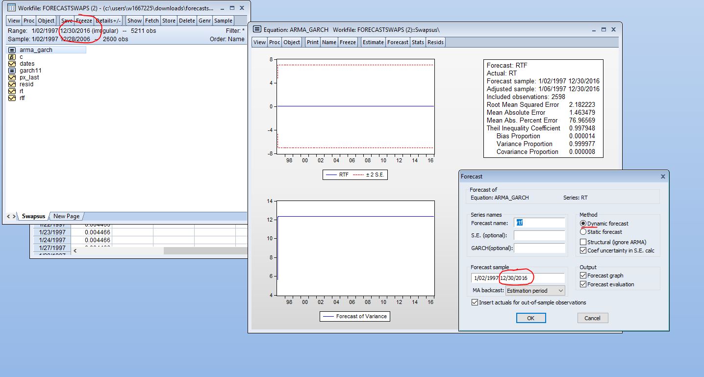

Re: What are the steps of forecasting realised volatility of swap rates using EViews?
Hi pvestia,
Thank you for your quick answer!
I adjusted the range size, however, when I do the dynamic forecast, there is only a straight line from 2006 onward. Any idea why?
If I'm right, I can't use the static forecasting, since I don't have the actual values, correct?
Hello, Yes with the static forecast you are only abble to forecast One-period because you only have an auto-regressive lag. The result of the dynamic forecast in Eviews I don't understand them quite well. They should converge to zero, but is kind of odd being straight line, I don't know is suppose to be like that.
