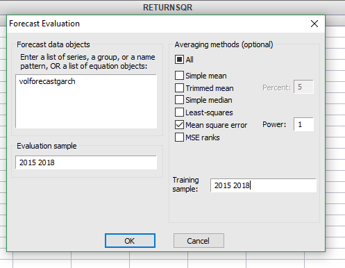

I am not sure what I am doing wrong. My observed series is titled RETURNSRQ, and the forecast series is titled VOLFORECASTGARCH. The sample range is 2015 to 2018 and i set the training sample to the same( I am not exactly sure about what to set the training sample too.). I filled out this dialog box like this:
dialog box.PNG (15.92 KiB) Viewed 6125 times

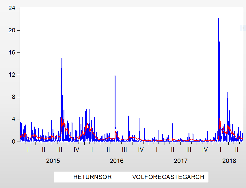

I expected the graph to look like this:
expected graph.PNG (28.07 KiB) Viewed 6125 times

Posts: 13608
Re: Forecast Evaluation Help
Postby EViews Gareth » Fri Jul 13, 2018 7:41 am
Forecast evaluation is for evaluation multiple forecasts of the same series. It looks like you are only evaluating a single series. Thus most of the statistics, and the averaging methods are nonsensical.

Posts: 13608
Postby EViews Gareth » Fri Jul 13, 2018 8:22 am
You can use the forecast evaluation view for that, but don't include an averaging method.

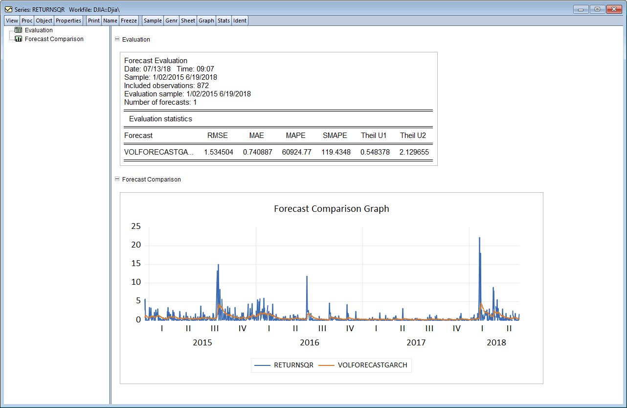

I followed your instructions and obtained this:
I don't understand why its not plotting the full evaluation sample.
Posts: 13608
Postby EViews Gareth » Fri Jul 13, 2018 8:55 am
Hard to say without having the data.

Posts: 13608
Postby EViews Gareth » Fri Jul 13, 2018 9:08 am
Works as expected for me. Ensure your copy of EViews is up to date.

praveen7796
Posts: 5
Joined: Wed Jul 11, 2018 1:03 am
Postby praveen7796 » Fri Jul 13, 2018 9:32 am
I just want to say thanks for all your help. Updating the software did the trick. Sorry for taking up your time.
