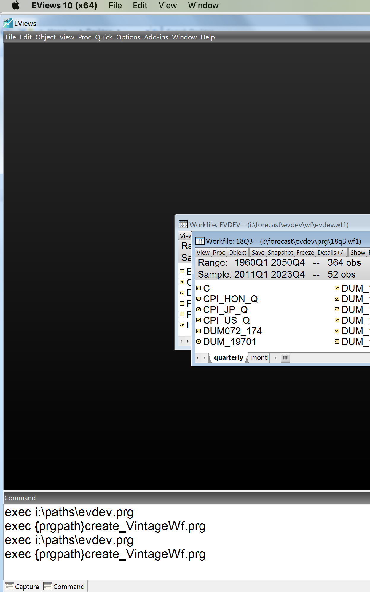

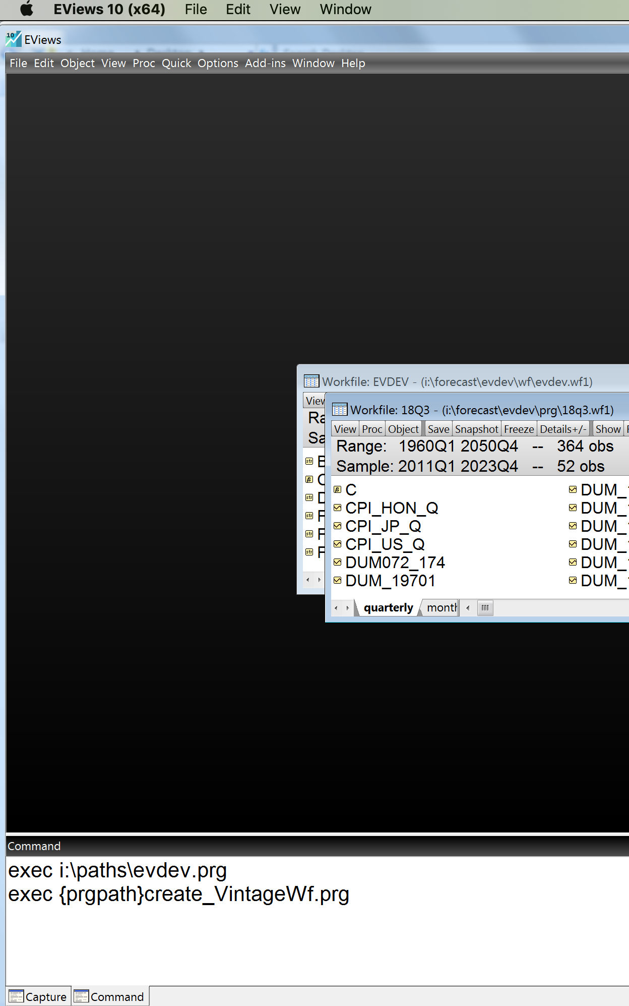

I have set command capture to "Send command capture to Command Capture Window Only".
I typed one line of code and ran it (hit enter/return). Then I typed the second line of code and ran it. (See screen1)
on first execution
When I move my cursor to the first line and run it again, the code is repeated as line three. When I move my cursor to line two and hit return, that line of code runs and is then repeated as line 4. (See screen 2)
running second time, creates duplicate lines of code
Sorry for the full size images.
Not only is the behavior inconsistent, but after a few minutes of work on programs, the command line is overflowing with duplicate lines of code.
Carl

by cbonham
Gareth,
Yes, that is exactly what I mean. In the attached iamge, I typed the first two lines in the command window and executed them one at a time. The last two lines are the repeated lines Eviews generates.
