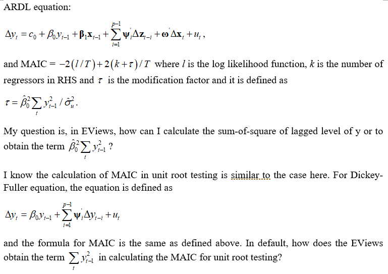

I wish to calculate information criteria value of Modified AIC (MAIC) of an ARDL equation. In calculating the MAIC, it involves the calculation of modification factor and this modification factor involves the sum-of-square of lagged level of y.
My question is, if I want to call out the value of this sum-of-square of y(-1) in EViews, is there anyway I can obtain it or the codes to call it out?
In particular, my question is as follows:

@sumsq(y(-1))
