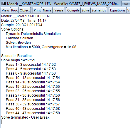

Postby tvonbrasch » Fri Apr 27, 2018 6:07 am
What does it mean when you get the message "Pass successful"?
When pressing the solve button, the models begins to simulate and just reports successful passes, without ending. It is very strange...
Re: Never ending successful pass
Postby EViews Gareth » Fri Apr 27, 2018 7:54 am
One iteration of the forward solution algorithm has succeeded, but that doesn't mean it will converge.
http://www.eviews.com/help/helpintro.ht ... Model.html
has a bit more detail.
