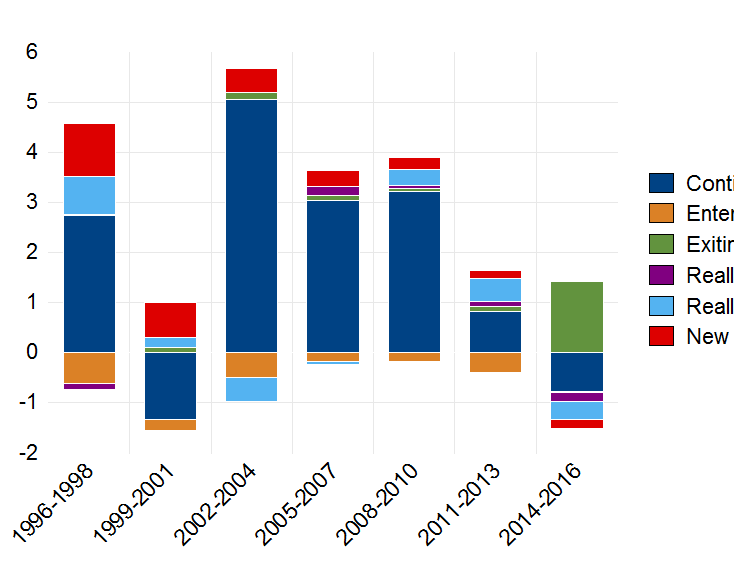

Postby tvonbrasch » Thu Jan 25, 2018 6:56 am
There is space between the stacked elements in each bar, see
white space.PNG (21.38 KiB) Viewed 3672 times
Is there a way to make it so that there is no such whit space? see, e.g., the Excel graph
white space 2.PNG (9.37 KiB) Viewed 3672 times
Re: White space in stacked bar
Postby EViews Jason » Mon Jan 29, 2018 10:56 am
In the graph dialog, select Graph Elements->Bar-Area-Pie. Unchecking the Outline fill areas in-> Bars will remove the white lines.
Postby tvonbrasch » Tue Jan 30, 2018 12:34 am
great, thanks
thomas
