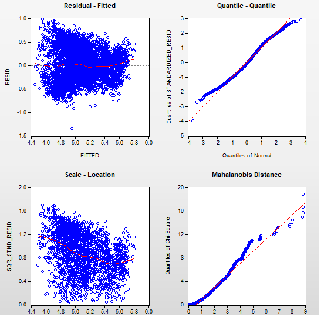

This is a program that outputs 4 residual diagnostic plots.
1. Residual - Fitted
2. Quantile - Quantile
3. Scale - Location
4. Mahalanobis Distance
The first 3 of the plots are fairly commonplace. The 4th plot is slightly complex and needs various assumptions, such as your variables are normally distributed. The advantage of the Mahalanobis distances plotted against a theoretical chi-squared distribution is that outliers can be detected even in high dimensions. Whereas typical leverage plots may fail to convey the unusual combination of data points across all dimensions (as they can only be plotted in 2 dimensions). The Mahalanobis distance works best when the mean and variance/covariance are estimated robustly. That is why you will see me using the @median call for that vector. If you are using eviews 10 (or higher), you can replace my for loop with @cmedian. The theoretical distribution is typically the chi-squared distribution, but I think that could change to a beta or fisher's t depending on your sample size and estimation.
Here is the linear algebra representation:
Here is an example output:
Residual Dashboard.png (64.07 KiB) Viewed 77249 times
