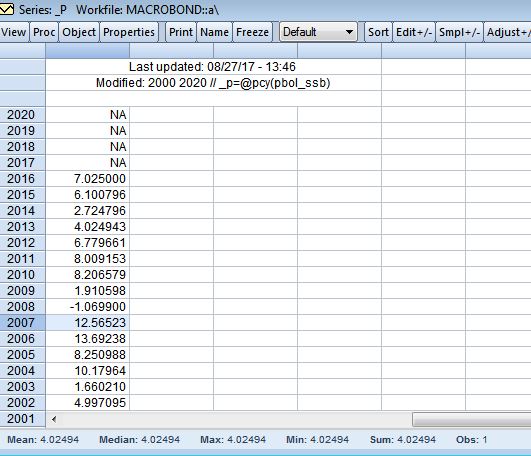

Take a look at this
I do not understand what the mean 4.02494 in the live statistics bar refers to? the value in the cell is 12.56523...? Here I have generated a new series, but does the live statistics refer to the original series?
(attached is the workfile if you want to look at it)

When only a single cell is selected, the statistics refer to the whole series (the mean of a single cell isn't very interesting)

aha, interesting, thanks for that information.
maybe the number of observations should be different from 1 in live statistics (Obs=1) to indicate that live statistics refer to the whole series?
