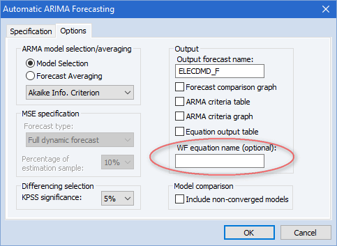

Is that possible when using the automatic ARIMA option?

No, but once you have used the auto-arima to select the best model, you can have it output an equation object with that model, then use the equation to create the intervals.

Once I've selected the best model how do I get that equation? I know how to construct the interval once I have the SE. Thank you so much for your help.

by EViews Gareth
