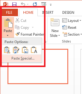

I took a quick look at EViews OLE in EViews 10 and it all seems in working order...
I did notice that Office context menus look different now for some reason. I don't see Paste Special in the right-click menu option anymore. I had to go to the Home ribbon tab / Clipboard group / and click on the Paste down arrow and then select Paste Special in my PowerPoint 2013.
Screenshot - 8_1_2017 , 7_59_27 AM.png (12.73 KiB) Viewed 12118 times

Steve,
I can confirm that works.
