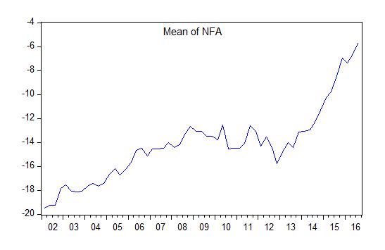

I'm trying to get the following graph obtained using panel=mean:

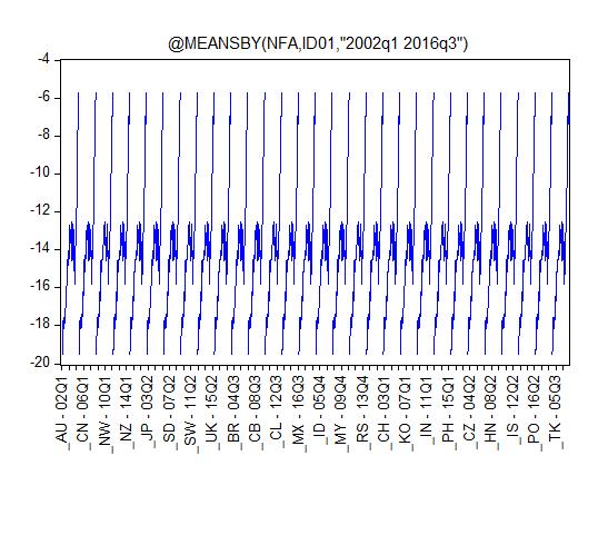

Upon running the code
graph cxnfa.line @meansby(nfa,id01)
where id01 represents the date identifiers, I get the following:
How can I modify my code to get the first graph?

Re: panel graph using @meansby
Postby EViews Gareth » Sat May 27, 2017 5:26 pm
cxnfa.line(panel=mean)

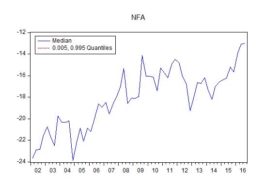

1) The command "panel=medmxmn" is not working properly. When I run the code
graph _cxnfa.line(panel=medmxmn) nfa
I get the following graph:
2) I would like to get a graph with min-mean-max instead. So I thought of using @maxby, @minby, @meansby. Is there a better way to accomplish this?
