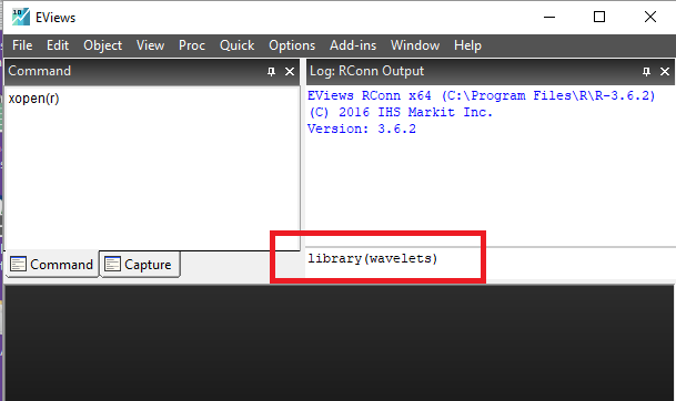

The wavelets add-in for EViews requires that you have the wavelets package installed in your R environment. Usually the add-in would take care of installing this in your R environment for you when you install the add-in, but it's possible this step failed. So try the following:
In EViews, try running the command:
XOPEN(r)
to see if EViews can connect to your R installation. Once connected, switch to the textbox under the R console window (see red rectangle in the following image)
and type in the R command:
library(wavelets)
to see if the wavelets package is already available in your R environment. If you get an error saying "there is no package", you'll have to install it by running the R command:
install.packages('wavelets')
Once the wavelets package is installed in your R environment, you should be able to run and use the wavelets add-in in EViews.
If you continue to have problems, please reply back with a detailed description of the error and maybe a screenshot.
