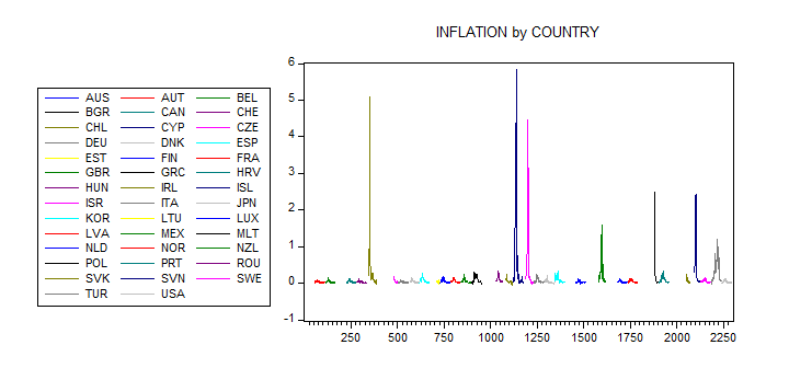

I am having problems with the categorical graph.
I would like to reach the following:
- on the x-axis: year
- on the y-axis: inflation (percentage)
- inside the graph multiple lines: one for eacht country
However, when I try do this I do not seem to be able to put the year on the x-axis, I always get the obersavtion number and I do not seem able to change this. This results in all the lines laying next to each other instead of overlapping.
Does anybody know how to do this? Any help is highly appreciated.
(Screenshot and workfile are in attachment)
DataInflation.wf1
(76.65 KiB) Downloaded 242 times
Re: Change data on x-axis
Postby EViews Gareth » Sat May 06, 2017 6:49 am
Switch back to a basic graph, and on the bottom right under panel options, choose combined cross sections.
