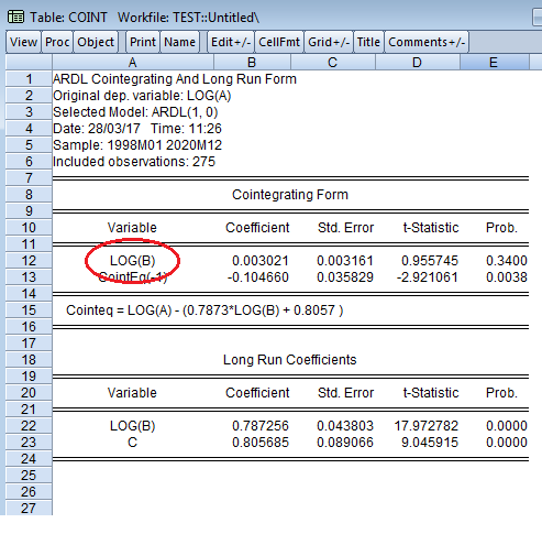

Could this be another bug in case of ARDL in logs? ARDLs should only contain dlogs in short term part. I attached the data file...
equation eq.ardl(deplags=12,reglags=12) log(a) log(b)
freeze(coint) eq.cointrep
Re: Eviews crash
Posted: Mon Apr 03, 2017 7:43 pm
by EViews Gareth
Grab the latest patch.
