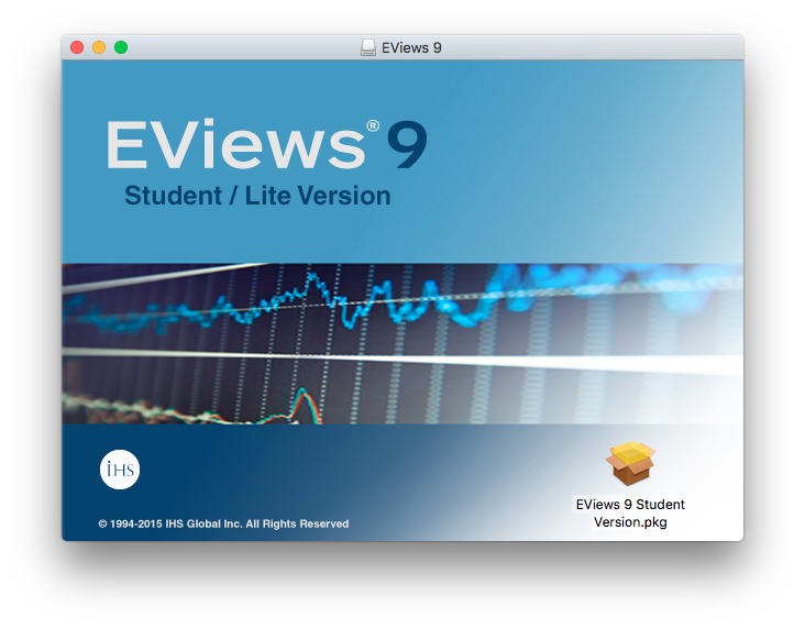

If you double-click the DMG file and it opens into a window like this, it should be fine.

Now if you simply double-click the EViews 9 Student Version.pkg icon, you might see a dialog like this:
Screen Shot 2017-03-15 at 7.56.57 AM.png (59.43 KiB) Viewed 23451 times
Click the OK button to close this dialog. Then hold down the Control key and click on the "EViews 9 Student Version.pkg" icon again. This should bring up the menu (holding down the Control key and clicking is the same as right-click if you have a two-button mouse). Click on Open on the menu. You should now see a dialog like this:
