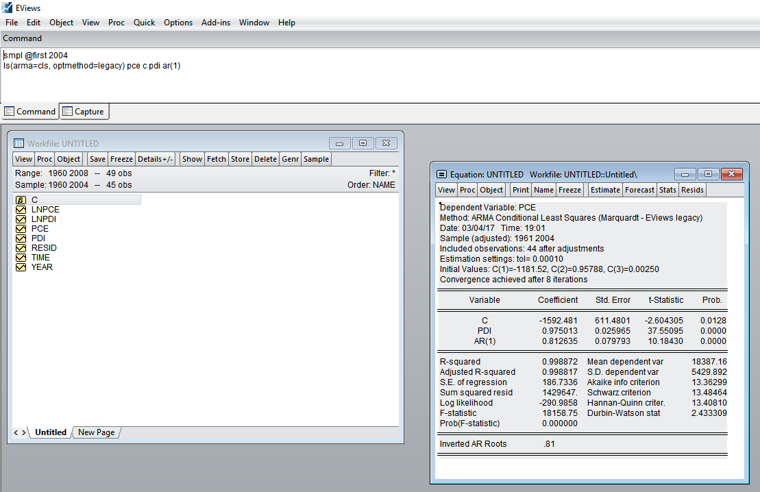

Try the following commands.
smpl @first 2004 ls(arma=cls, optmethod=legacy) pce c pdi ar(1)
The regression output shown below displays my results and they match those which appear in the book.
From my vague recollection of Box and Jenkins' textbook, my understanding is that "cls - conditional least squares" and "Marquardt" technique is the classical way of estimating ARMA models. This seems to be the main option you've omitted.
Hope that helps.
