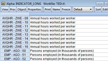

in the data, there is an alpha series called indicator_long, holding information about each data series,
when using commands such as
pageunstack iso year @ value alpha superid = "_" +indicator_short+ "_" + iso pageunstack superid @date @ value
to unstack the workpage, how can I change the code so that the information in the alpha series "indicator_long" is included as a description in each of the unstacked series, i.e., the unstacked series "avghr_aus" holds the description "Annual hours worked per worker".
