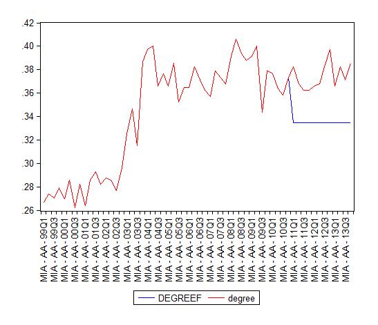

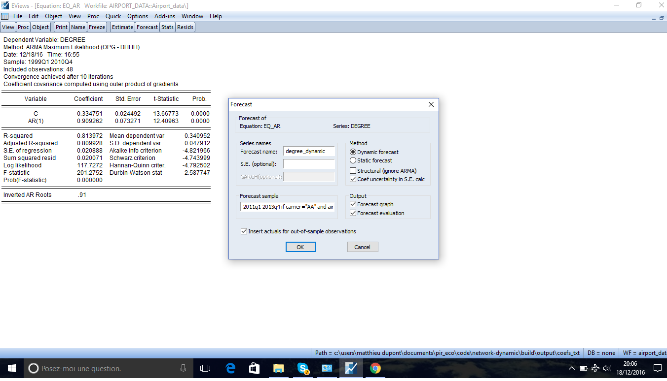

I have selected the equation "eq_ar" which corresponds to an AR(1) for estimation until 2010 Q4 and selected "Forecast" and just changing the date of the sample as following :
2011q1 2013q4 if carrier="AA" and airport="MIA".
And then it says the error message "unable to compute due tomissing datas" but it creates me the variable degreef whatever.
So i checked the graph I wanted, and it is definitely not what I should have (see the attachement ...)

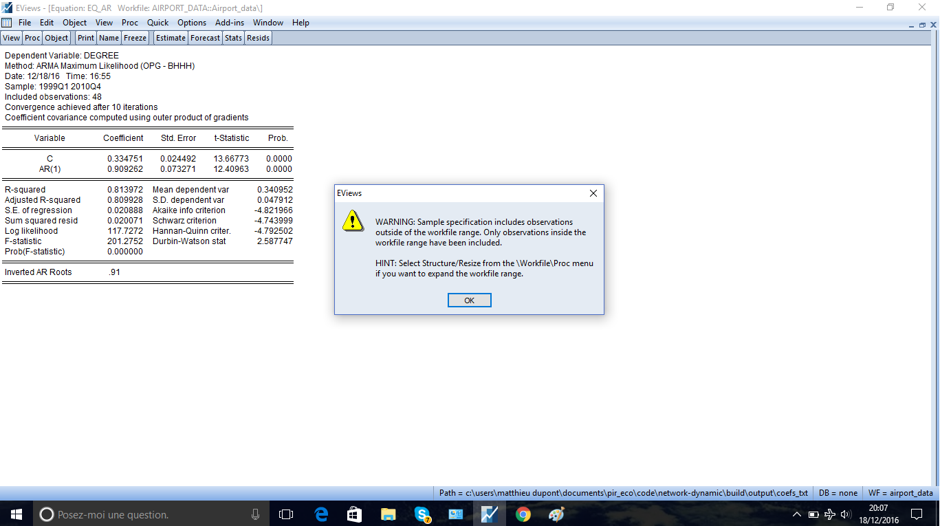

I finally managed to update eviews to the latest version.
I got a new error message, you can see it on the image.
I do not get it insofar as my workfile range is until 2013Q4 and I should not be outside my workfile range..

Postby EViews Gareth » Sun Dec 18, 2016 1:52 pm
If you click ok on the error, does the forecast happen?

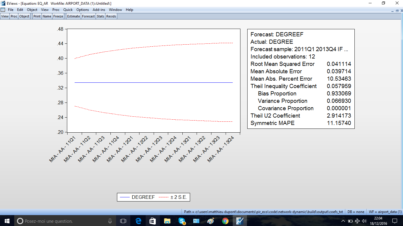

Postby MattxLM » Sun Dec 18, 2016 2:07 pm
Yes, the forecast happens and I got this
(The forecasted value is a constant which corresponds to the constant of the ar(1) model)
Posts: 13608
Re: AR(1) forecasting
Postby EViews Gareth » Sun Dec 18, 2016 4:19 pm
Seems like it is working then.
