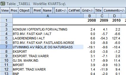

When entering the rowlabel Utvinning av råolje og naturgass it comes out in capital letters in the dated data table as
Norwegian vowels.JPG (38.16 KiB) Viewed 13273 times
As I noted in my previous post, the rowlabels are written in upper case letters. However, this is not the case for the Norwegian vowel "å". It is the lower case version "å" that is included and not the upper case version "Å".
When I save the table as a pdf document, the letter "å" disappears
Norwegian vowels2.JPG (37.95 KiB) Viewed 13273 times
Is this something you can fix?

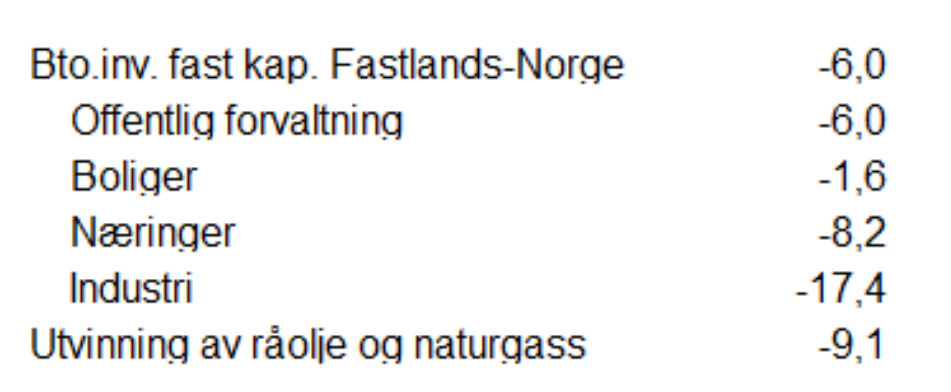

I have another question related to how to sidestep the issue that Norwegian vowels is not printed in the pdf output. As an alternative, I can save a table in picture format, but unfortunately, the quality of the picture format is low. For example, this is a pdf version:
In contrast, this is the bmp version
and this is the jpg version
Both pictures hold lower quality compared with the pdf version (but these show the Norwegian vowels correctly). Is there a way to increase the quality of the pictures when saving them from Eviews?

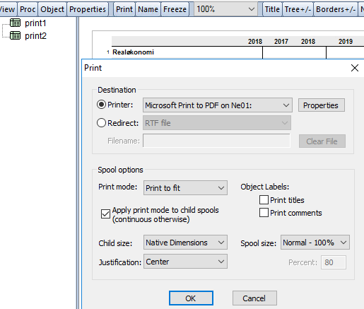

I have a table I would like to print to PDF using commands, see picture below. However, since the table contains Norwegian vowels, I cannot use the built-in EViews pdf maker. I have to use a PDF-printer.
There must be a way of using the SHELL command to save a table in eviews using the MICROSOFT PRINT TO PDF printer, but I do not know how to do it.
Can you please help me with a SHELL-command to print tables in EViews using the microsoft print to pdf?
(of the form SHELL ... TABLENAMEINEVIEWS ... DESTINATIONPATH...)
