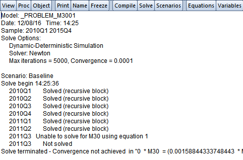

I have a model consisting of a single equation:
0 * m30 = (0.00158844333748443 * m11 + 0.131757812040252 * m14 + 0.142559703431027 * m15 + 0.000227119899011968 * 1 / 0.5133 * M2525 + 5.10348824794473e-05 * m30 + 0.000112944043026302 * m45 + 0.0012639569049951 * m71 + 2.61352801377563e-05 * m55 + 0.000336585063106878 * m81 + 2.0808985845994e-05 * m66 + 0.000610396415751828 * m68 + 0.000391779117784267 * m65 + 0.00022595765194497 * m74 + 0.000115646966161894 * m63 + 0.00193256430648588 * m85 + 5.95538004130637e-05 * m86 + 4.98374864572048e-05 * m92S + 0.000602083513336707 * m91S + 0.00220209577067432 * m90K + 0.00768162735480903 * c00 + 0.000297473395322951 * c20 + 0.000274580692400979 * j50 + 0.940006199453321 * a14 + dsi14 + dsh14 + xir14) - (1 * i14 + 0.984825802939575 * x14 + 0.052186490229266 * x1516 + 0)
I have added 0*m30 on the left hand side of the equality sign as a trick so that Eviews understands that this is the endogenous variable. However, Eviews will not solve this model.
I have tried to change the solver method, convergency criteria, preferred starting values, etc. It is a linear model, so it should be easy for Eviews to solve this.
If I manually change the equation, putting m30 on the left hand side, as in
m30 = ((0.00158844333748443 * m11 + 0.131757812040252 * m14 + 0.142559703431027 * m15 + 0.000227119899011968 * 1 / 0.5133 * M2525 + 0.000112944043026302 * m45 + 0.0012639569049951 * m71 + 2.61352801377563e-05 * m55 + 0.000336585063106878 * m81 + 2.0808985845994e-05 * m66 + 0.000610396415751828 * m68 + 0.000391779117784267 * m65 + 0.00022595765194497 * m74 + 0.000115646966161894 * m63 + 0.00193256430648588 * m85 + 5.95538004130637e-05 * m86 + 4.98374864572048e-05 * m92S + 0.000602083513336707 * m91S + 0.00220209577067432 * m90K + 0.00768162735480903 * c00 + 0.000297473395322951 * c20 + 0.000274580692400979 * j50 + 0.940006199453321 * a14 + dsi14 + dsh14 + xir14) - (1 * i14 + 0.984825802939575 * x14 + 0.052186490229266 * x1516 + 0) )/ (-5.10348824794473e-05 )
Eviews has no problem solving the model. Since this is an accounting relationship, the model solution exactly reproduces the data.
Why is Eviews not able to solve the first model? Is it related to the coefficient in front of m30 being so small (5.10348824794473e-05)? Is it a bug?
Attached are the workfile and the program file that illustrates the problem.
Re: Model will not solve
Posted: Fri Aug 12, 2016 8:14 am
by EViews Gareth
The right hand side is completely exogenous. There is no value of m30 that will make m30*0 equal to the right hand side.
Posted: Fri Aug 12, 2016 10:01 am
by tvonbrasch
Hi Gareth, thanks for your reply,
but I do not understand what you mean?
The equation can be written
0*m30=con1 + 5.10348824794473e-05* m30 + con2
where the con1 and con2 are the linear functions of the other series in the expression above.
This equation has the solution
m30=(con1+con2)/(-5.10348824794473e-05 )
(see also attached program)
Or is there something I do not understand?
Posted: Fri Aug 12, 2016 10:33 am
by EViews Gareth
Ah, you are right - my first pass missed that you had m30 on the rhs too.
I think this is just one of the limitations of the optimizer. Note that changing one of the other variables to the left does seem to work.
