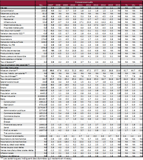

I am trying to save a table as an enhanced magafile (emf) but when I retrieve the image on my desktop after saving it, the lines in the table, which appear perfectly in the eviews workfile, are cutoff along the vertical lines. I do not encounter any formating issues when saving a graph with emf, only a table. Is there another format I should try saving in or maybe I should build the table lines differently...?
Thank you

I want to be able to save the table in a format that will allow me to put the table into a final word document. However, I need the table in the final word document (which contains many other things) to be linked. That way when I update the table in eviews, it saves to the intermediary file (what I had originaly tried as an emf) which I insert as linked into my final word document.
I attached an image where you can see the hashes that are created on the vertical lines at each cell but in eviews appear as complete straight lines
show tb_results_som2.png (55.37 KiB) Viewed 8090 times

The link works but the table still appears with the hashed vertical lines...

I tried all the formats and the only one that seems to keep the original undashed lines is saving directly as a word document, but then I am unable to get that word document (which contains lines of the table not a frozen image of the table) to link properly into my final presentation word document.
Thank you again for your help
