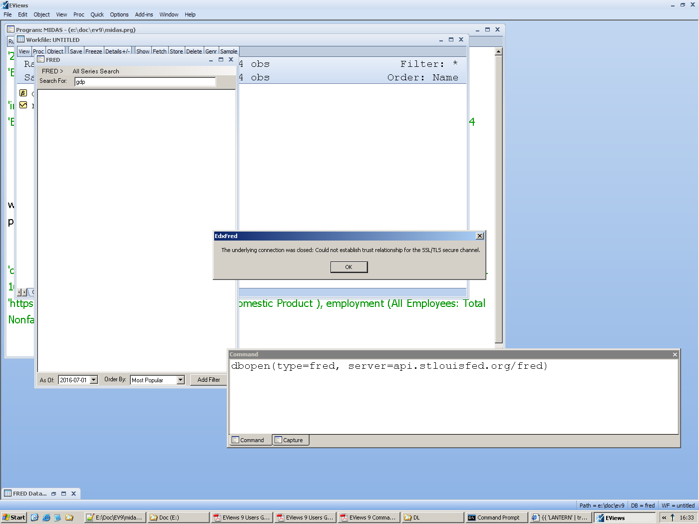

I follow the https://youtu.be/Y0ZFekCDWmE , but the connection to FRED fails. The SSL/TLS might be detected and interfered by Chinese Great Firewall.
EViews fail to fetch FRED

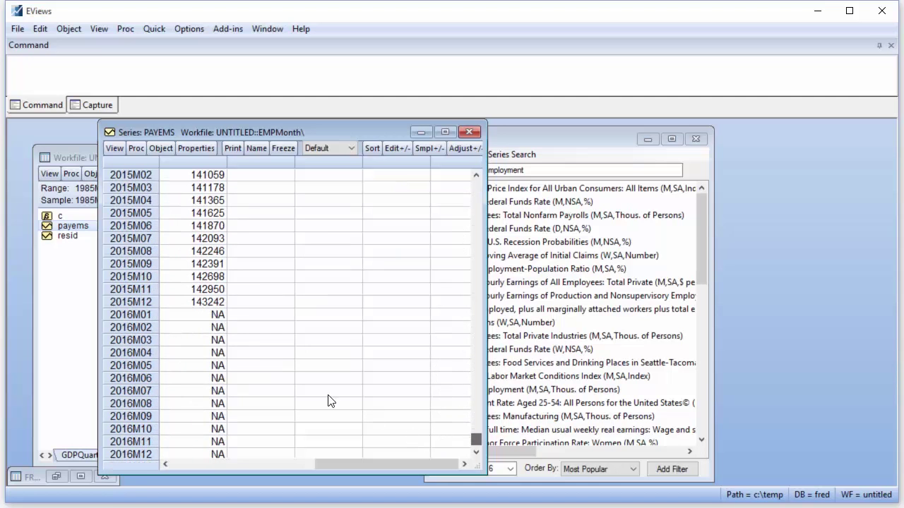

(15.78 KiB) Downloaded 645 times
but the data is not consistent to those shown on the video (video time 03:49)
snapshot
for examples, "2015-12-01,143146" in CSV, yet "143242" in video
Re: MIDAS
Postby EViews Gareth » Fri Jul 01, 2016 9:07 am
Not sure on the documentation.
With regards to FRED, the data stored by FRED can be changed at any time, so there is no way to guarantee the data will be the same.
