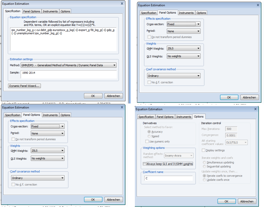

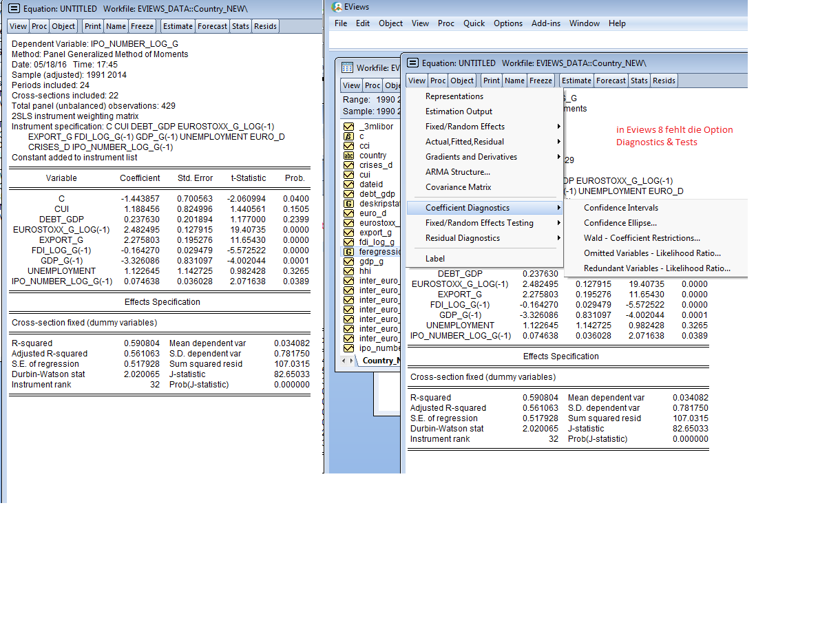

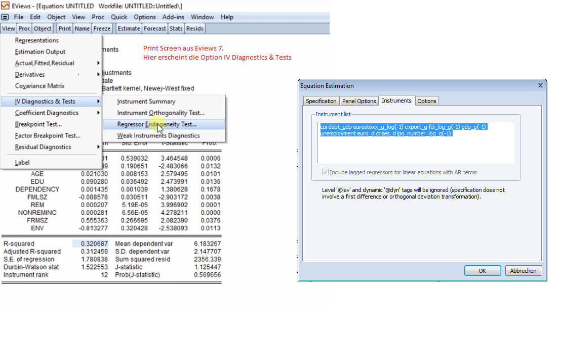

I am performing a panel regression with the generalized method of moments in Eviews 8. To account for the endogeneity of the regressors I would like to perform a endogeneity test. Under Eviews 7 it appears under view -> IV Diagnostics and Tests -> Regressor Endogeneity Test. However, under Eviews 8 it doesn't. I attached the youtube video and screenshots from my regression model where my issue is explained more precisely. Hopefully you can help me out in how to perform this test in Eviews 8. I would also like to test for the relevance of the applied instruments.

The endogeneity tests are not available for panels
