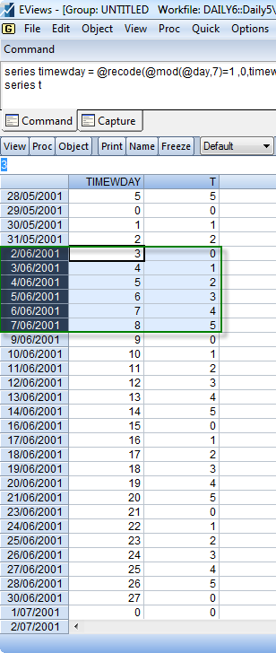

i have some month start by day number 02 (example: 02/06/2001 and 02/02/2002, 02/03/2002,......etc).
Re: time (trend) for daily custom week 6 day per week
the code work if the month start by day=1, but for day start by day=2 not work
- daily.png (32.44 KiB) Viewed 11837 times
series time = @recode(@month<>@month(-1), 0, @recode(time(-1)=5, 0, time(-1)+1))
