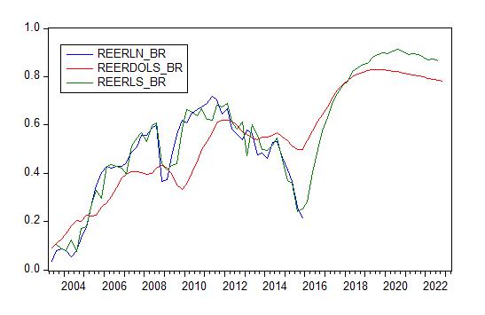

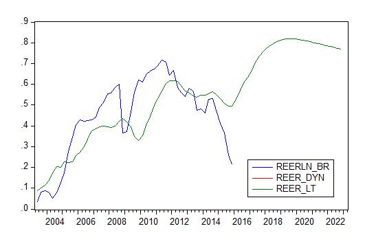

I'm running the following code to compare dynamic with static forecasts by running cointreg(dols):
equation dols1_br.cointreg(method=dols, trend=const, lag=1, lead=1, cov=hac) reerln_br trdbal_br eff_totln_br @determ eff_rint_br forecast reer_dyn forecast(s) reer_lt plot reerln_br reer_dyn reer_lt dols1_br.resids(g)
"forecast(s) reer_lt" is giving me the same values as "forecast reer_dyn" (see [img]
[/img].

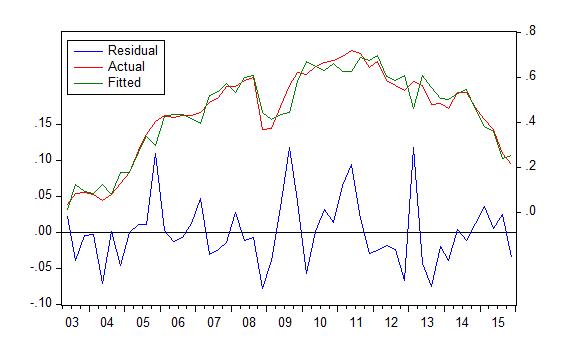

What I would like to get is the "fitted" in the graph below [img]
[/img]. How can I get that?

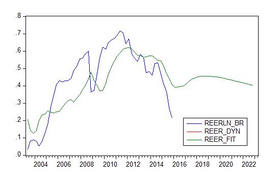

The problem is that "forecast reer_dyn" is not taking into account the dynamic term of the DOLS, as I thought it should. Is that so?
"forecast reer_dyn" and "fit reer_fit" gives the same forecasts.
See [img]
[/img]

That is because you are estimating a DOLS model, which produces forecasts only for the long term relationship that does not take into account the short term dynamics.

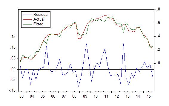

I got the impression that the "fitted" in the graph with the residuals made using resids(g) do take into account the dynamic short-term term.
The "fitted" in graph 2 is quite different from the ones in graph 3 or graph 1.
Re: DOLS - dynamic vs static forecasts
Posted: Thu Apr 07, 2016 8:54 am
by maragloria
Indeed, I did an OLS regression specifying the dynamic term explicitly and its fitted value is quite similar to the one in the residuals graph of a DOLS regression.
See graph4 and graph 5 below.
[img]
[/img]
[img]
[/img]
My question is: is that a way for me to program a DOLS regression to get these fitted values (taking into account the dynamic term) given by the command resids(g)?
