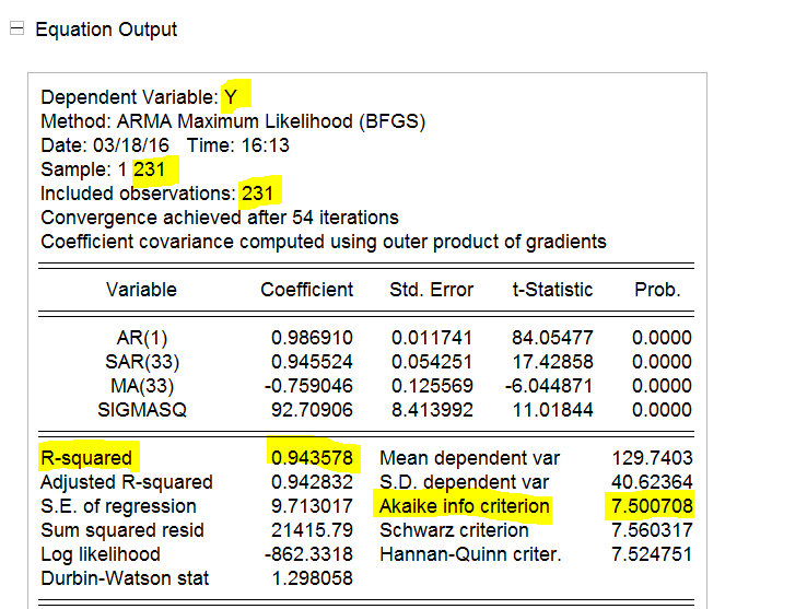

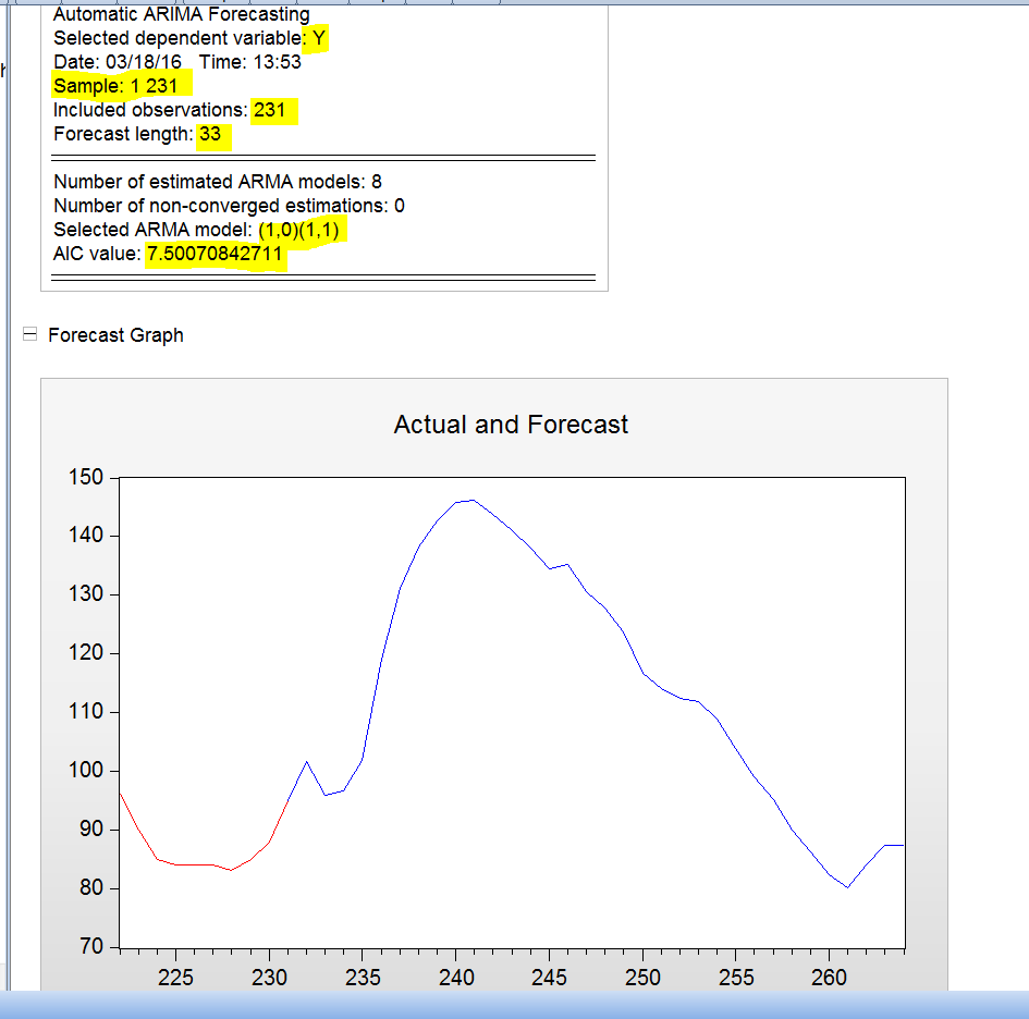

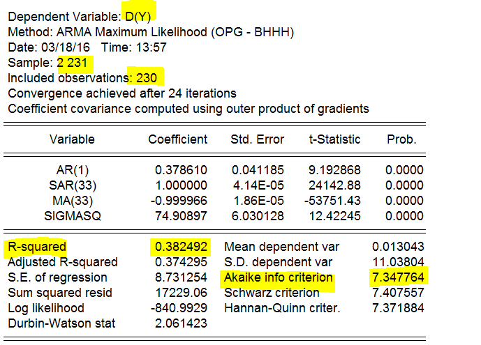

Postby ESVAL2016 » Fri Mar 18, 2016 6:02 am
Only, one difference in the work, I take the first difference of my original series. Because the automatic way is not transformed the non-stationary series !!
Estimate Equation.PNG (33.68 KiB) Viewed 9719 times
Automatic ARIMA.PNG (33.26 KiB) Viewed 9719 times
Equation output for Automatic ARIMA.PNG (36.46 KiB) Viewed 9711 times
Re: Automatic ARIMA forecasting
Postby EViews Gareth » Fri Mar 18, 2016 9:30 am
Not really sure what the issue is.
If you believe the series should be differenced, difference it and then use the automatic arima selection.
If you believe the series should be differenced and follows an exact arima specification, then use that specification and don't use the automatic selection.
