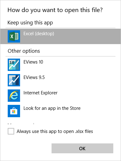

- Posts: 844
- Location: Irvine, CA
Re: Problem: EViews becoming the default viewer of xlsx files
EViews associates itself as a "secondary" handler for Excel files. This means when you right-click an Excel file, EViews shows up under the "Open With" dialog as an available handler. Also, if you click on "Choose another app", EViews will appear under "Other options".
We never register ourselves as a primary handler for Excel files.
My guess is that something is happening to your primary Excel association and then Windows is defaulting to one of the secondary handlers as a backup of which EViews is one.
If you run the REASSOCIATE command from within EViews, that will re-do all the EViews file associations (including secondary handler entries for Excel files). This should not change your primary Excel file handler. I just did this on my machine and the Excel file handler was not altered. Let me know if it is altered on your machine.
