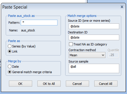

I followed these steps but when i choose below the choice "Merge by" the choice "Date" the selection " Frequency conversion options" is not highlighted. Even when i choose the choice " General match merge criteria" at the right comes up "Match merge options" with the options that you can see in the image that i attached to you. I choose then " Contaction method" the option last but as a weekly page i get the initial daily page.
