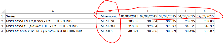

I can't figure it out, and I'm being asked by my superiors to stop spending time on this. Please let me know if there is a straightforward answer to this... Screenshot attached.
I need my series to be named according to column B and dated according to row 1

Can you provide the Excel file?

Postby EViews Gareth » Wed Dec 09, 2015 9:30 am
wfopen test.csv byrow colhead=2 namepos=last
