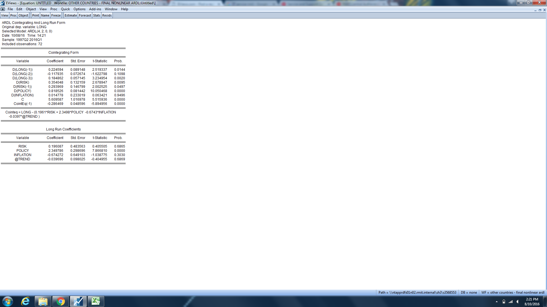

I think the bug of long-run form is still there. I am using Eviews 9.5 (updated September 2016). I found that the long-run coefficients calculated from bounds test are different from those from cointegrating and long run form. Please see pictures below.
For example: From bounds test (pic1), the long-run effect of RISK on LONG = -(0.442182/-0.163614)=-2.702592688. However, the result from cointegrating and long run form (pic 2) indicates that number is 0.196087, so much different from bounds tests. I used HQC information criteria in this example. When I changed to AIC, the bug disappears.

There is a case with zero lags in two variables. I realise that in this case, if you compute the long-run estimation based on bounds tests from Eviews, it will return different results from cointegration and long-run form. This error does not occur in the case with minimum 1 lags.
Could you please explain why as both of models, in theory, should return the same result?
Thanks.
Re: Eviews9 ARDL Cointegrating and Long Run Form
Posted: Fri Oct 14, 2016 8:35 am
by EViews Gareth
You're right, there is a bug in the case that zero lags are selected. We'll look into fixing it (might take a while).
