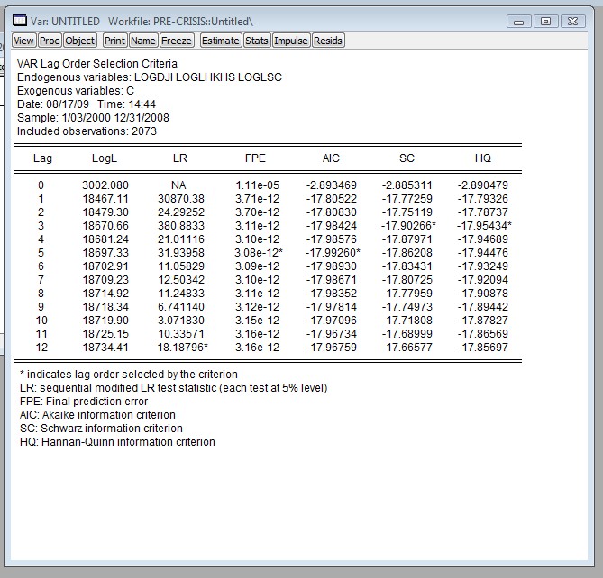

Below is the outcome from Eviews, and I noticed that the optimal lag length suggested by different criteria is different. I wonder which of the criteria should I rely more on? and how could I support myself relying on such criteria please?

by theologos
As you have realized there is no unique way to select the optimal lag length, therefore is quite easy to support your selection. Whenever multiple lag lengths appear two strategies can be followed:
1) Consider all the available criteria and let democracy to do the job
2) Choose one criterion (I usually choose the LR statistic)
Regards
