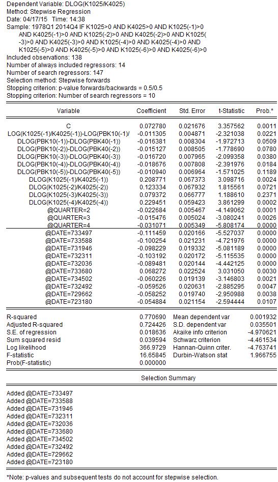

When i estimate an equation using @expand(@date,@dropfirst) the date dummy in the output is given by its numerical value (see e.g., attached file). Is there a way to specify the equation so that the output shows the date of the dummy variable?

You could include @expand(@datestr(@date)) instead.
